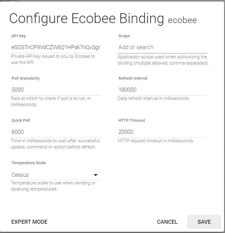

New user here really stuck with trying to get the ecobee to bind / get pin.
I have tried installing binding from paper ui as well as from addons.cfg, uninstalling via bundle:uninstall (bundle number) each time. (currently using install via addons.cfg)
I have verified api key is correct (used to have wink so I am familiar with how to create on the ecobee site)
I keep getting this error in the log
2019-12-08 10:19:52.869 [DEBUG] [org.openhab.binding.ecobee ] - BundleEvent STARTED - org.openhab.binding.ecobee
2019-12-08 10:19:53.714 [ERROR] [org.apache.felix.configadmin ] - [org.osgi.service.event.EventHandler, org.osgi.service.cm.ManagedService, org.openhab.binding.ecobee.EcobeeActionProvider, id=407, bundle=264/mvn:org.openhab.binding/org.openhab.binding.ecobee/1.13.0]: Updating property ecobee of configuration org.openhab.ecobee caused a problem: the given configKey 'ecobee' is unknown
org.osgi.service.cm.ConfigurationException: ecobee : the given configKey 'ecobee' is unknown
at org.openhab.binding.ecobee.internal.EcobeeBinding.updated(EcobeeBinding.java:810) ~[?:?]
Something that I find curious is that the settings seem to persist when uninstalled. If I remove the ecobee.cfg file in paper ui it still shows the config. When I have a ecobee.cfg and make changes it does get reflected there thouhg, is there a second location for these settings to be stored?
