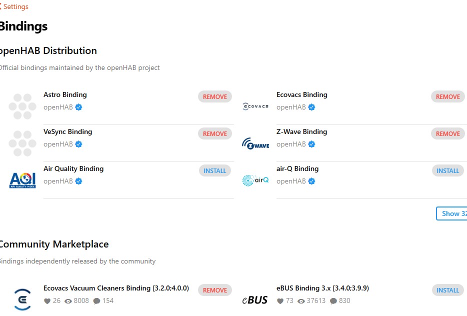

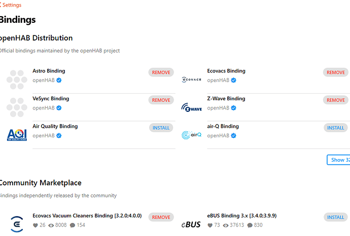

Not sure which binding I have installed. Looks like both maybe? I would have to update to 4.0 or 4.1. I can do that and let you know and I would be willing to test.
Marketplace…especially considering…
