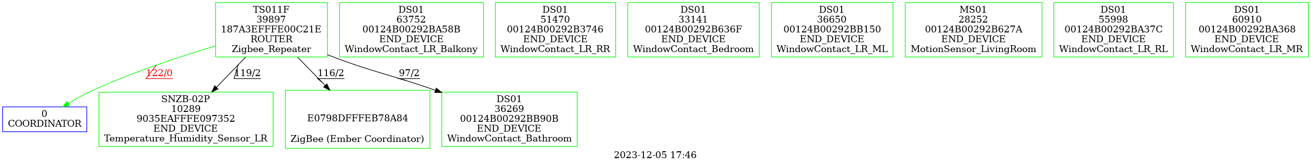

I am facing the same issue as the others here (openHAB 4.0.4, SonOff ZigBee Dongle-E, Ember). The nighbours of the ZigBee repeater are shown properly in the UI, but the neighbours of the ZigBee coordinator are empty.
Like this, no proper map can be drawn (see attachment).
Did you find a solution how to solve it?
No, my Coordinator Neighbor list is empty (Shown as “” in UI)
openHAB 4.0.4 and still running that cheap Sonof “prelease” Ember stick with 6.7.9.0 firmware.

I’ve created a new script to create a zigbee map, that is not affected by the issue discussed in this thread.
Please find the new script here.
