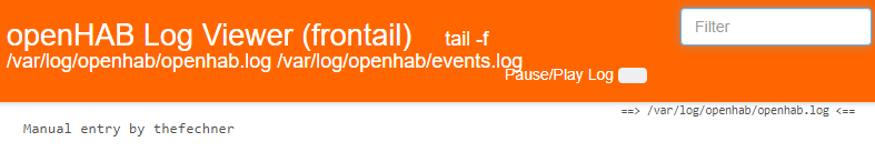

I figured out, frontail in general seems to work. I added manually an entry in /var/log/openhab/openhab.log and the entry appeared immediately on the frontail-webpage host:9001.
It seems openHAB does not write any log anymore. I deleted all old log-files during testing. No new entries have reached so far. Similar what was mentioned already earlier here.
