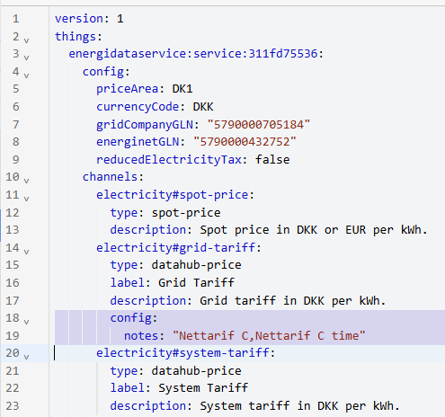

Hmm.. Have to be honest. I have mostly paid attention to spotprice. In my dashboard I have spotprice and total price. Now you mention it, I did notice a lower total price some time ago, but didnt pay that enough attention, since the spotprice was showing fine..
Then I updated openhab and notices the grid tarif where no longer defined.
Anyway, edited the channel as showen above, and now I get the frid tarif just fine again.. Thanks.

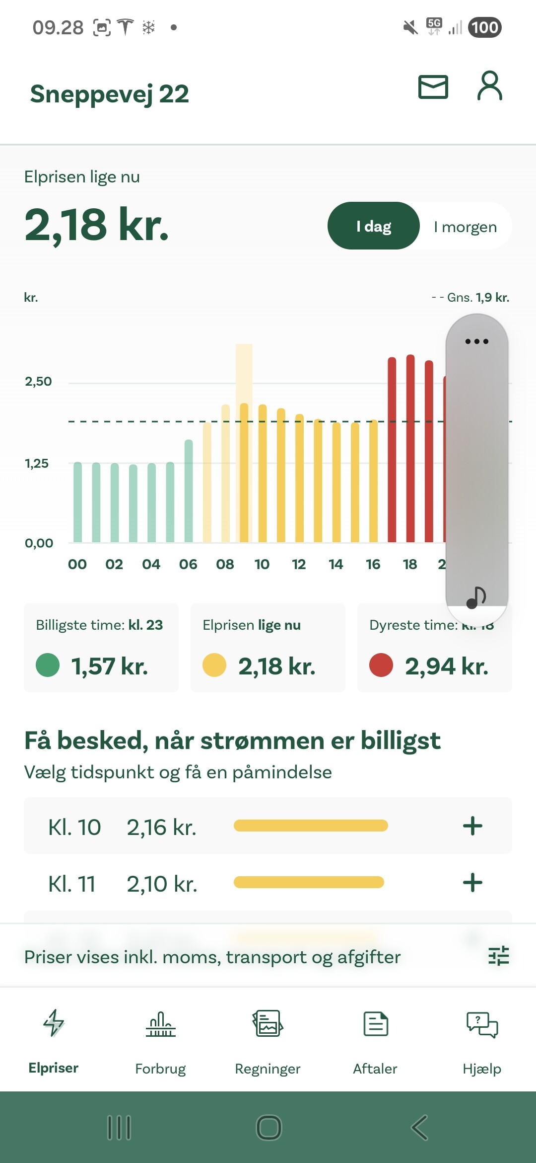

Unfortunatly Energi Fyn app can only show me the totalprice (including VAT) or the spotprice/pr hour (including VAT). I can not see the GridTariff, SystemTarif, TransmissionTariff or ElectricityTax.
Tax, as you know, is no longer highly relevant, as it has been reduced to absolute minimum (0,01 kroner/kWh).

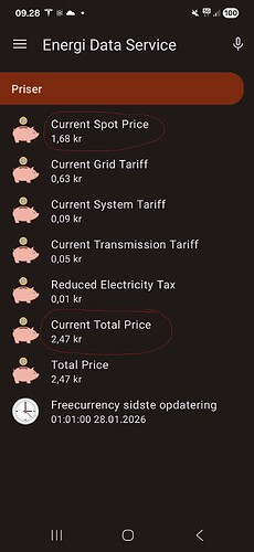

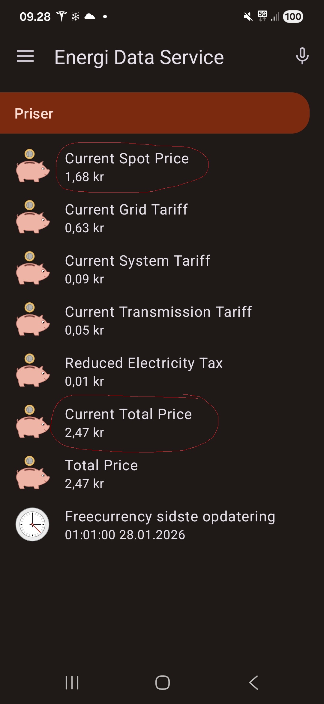

Here are some screendumps taken today, 28.01.2026 at 09.28.

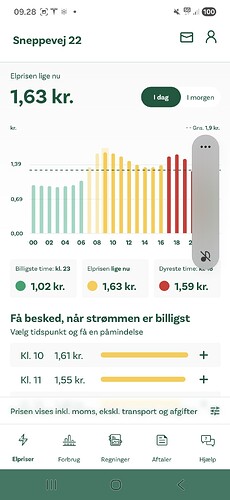

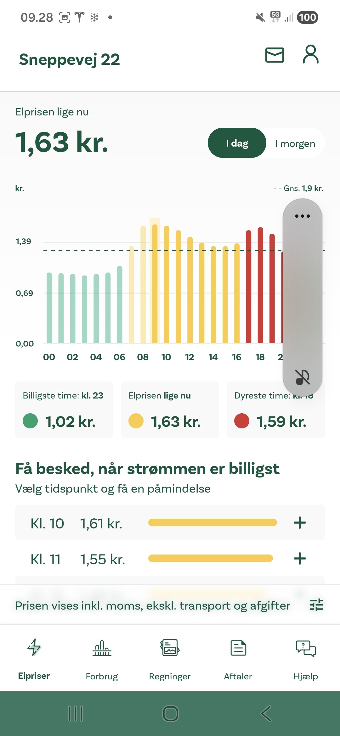

First two from Energi Fyn app showing totalprice and spotprice.
And last a screenfump from openhab mobile app (BasicUI).
Please notice the differences in totalprice as there seem to be a rather big differences.
EnergiDataService = 2,47 kr/kWh
Energi Fyn = 2,18 kr/kWh
Second notice the spotprice.
EnergiDataService = 1,68 kr/kWh
Energi Fy = 1,63 kr/kWh
Spotprice:
I havnt verify this value at Nordpool. Thats because Energi Fyn uses (avarage) hourly spotprice. But EnergiDataService uses quarter/hour spotprice. That makes at a bit of a mess.
I believe EnergiDataService is correct at 1,68 kroner/kWh

You did not show your configuration, so I can’t know why you are seeing 0,63 kr.
I know.. I just got back home :slight_smile:
This is my config for the binding:

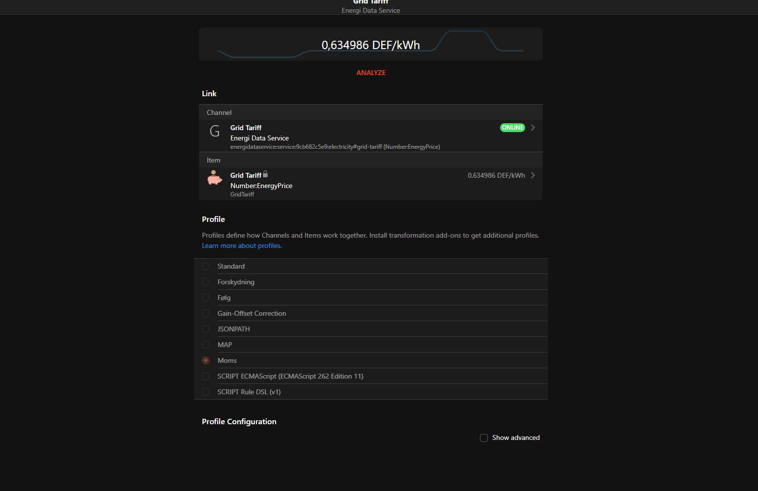

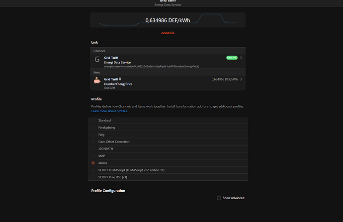

This is the value GridTariff right now (at kl 23.19):
According to Cerius it should be 39,92 øre/kWh from kl 21 - 24.

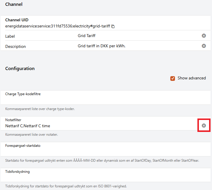

Delete the channel configuration.

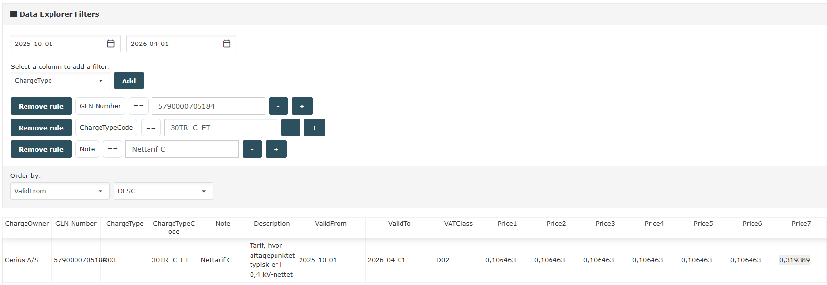

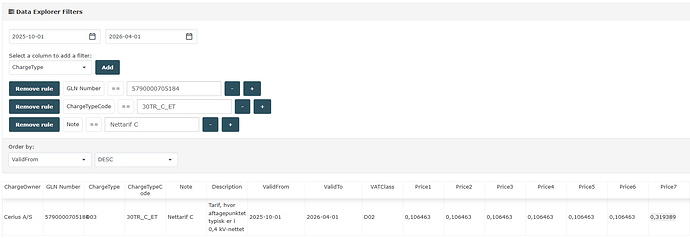

Just to make sure. I just checked with eloverblik.dk.
This is the data from price sheet:
Delete it? How?
Either delete the two lines directly from the code tab:
Or UI:
Hmm.. I deleted from the code tab. Restarted the binding. Now I get this error:

Restoring the config (including thw two lines) still give the same error.. :thinking:
Seems like you might have hit a bug in the YAML parser used by the code tab. Go to your Thing configuration and reconfigure your grid company.
Done, and binding is running again (without those two lines).
You´re right.. When I removed the two lines, it changed the GLN numbers for both the elselskab and energinet.. Weird!
And.. Now GridTarif is showing correctly :slight_smile:
Total price match Energi Fyn with 1 øre in a difference.. I can live with that :sweat_smile:
Are you able to reproduce this issue? I cannot reproduce in 5.1.1 or latest 5.2 snapshot. In both versions, this is how the GLN parameters look like in YAML in the code tab:
      gridCompanyGLN: "5790001089030"
      energinetGLN: "5790000432752"
When saving that back, I don’t have any issues. I could see how it might cause the exception you mentioned if the GLN’s wouldn’t have quotes around them. In 5.2 I tried to remove the quotes, but even then couldn’t reproduce it - they are normalized back to having them.

Yep, it happens every time I makes any changes from the code tab.
It changes the GLN numbers and I have to manuel insert them again from the Thing tab.
I run openHAB 5.1
      gridCompanyGLN: 5.790000705184E12
      energinetGLN: 5.790000432752E12
      reducedElectricityTax: true

Oh, that explains it. This is fixed in 5.1.1: [YAML] Use quotes for numbers stored as strings when generating YAML by lolodomo ¡ Pull Request #5241 ¡ openhab/openhab-core ¡ GitHub
