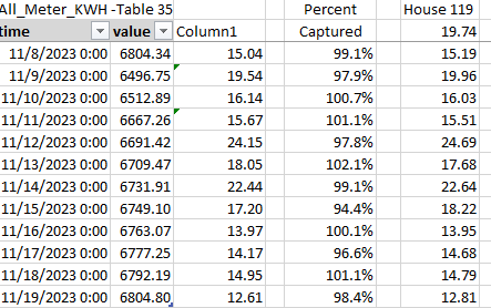

Another thought; I pretty much have the house monitored (95+% of the total). I collect a daily KWH at midnight using mysql/jdbc and then periodically upload the table values into Excel and have almost 2 years of daily data. Could do charts, but mostly do calculations. Occasionally have to use MySQL workbench to correct errant readings.
This is the House total versus the individual meters.
