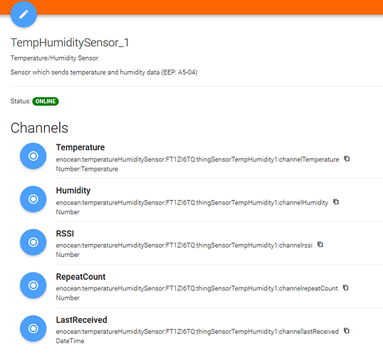

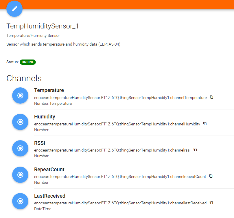

When I define the setup via PaperUI (Bridge discovery via Inbox, then adding manually the Nodon Sensor and the channels) I do recieve at least temperature and humidity values. I do not receive e.g. lastReceived or repeatcount.
The items are configured via .item file still - I just do the linking of the item to the thing/channel via PaperUI there.
However when I define the same sensor via .thing file the enocean binding seems to initialize correctly, I do see Enocean Bridge and sensor as well as channels in status “online” - also I see correct linking to the respective items in the paper UI - but I do NOT receive any value update via these channels.

Is there anything wrong in my text config file - or something which I did not consider?
Thanks for any hint.
