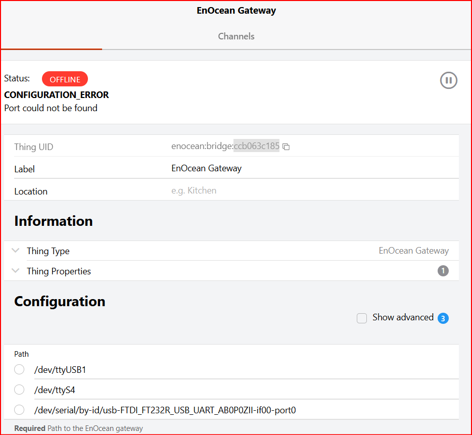

It looks like I turned the power back on at 2026-07-30 19:48:37. And then it “can’t find a port”…
I edited my log4j2.xml, but I never figured out how to get it “reloaded” while openHAB is still live. I would like to do that, so that I can log the process of disabling and re-enabling the bridge Thing, which I think will come online again then.
Edit:

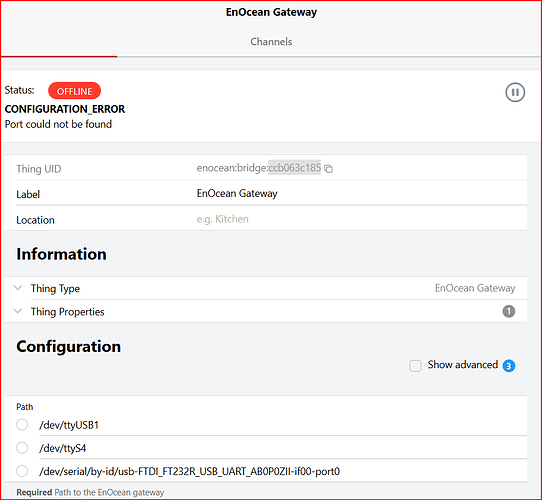

Looking at the Thing in Main UI, I notice that none of the “Path” options are selected:
Could that option be “reset” when the fuse blew?

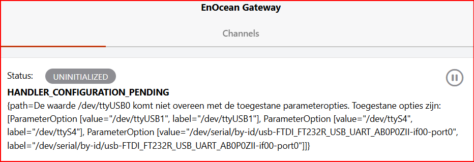

I went ahead and disabled and reenabled the Bridge Thing, and this happened:
HANDLER_CONFIGURATION_PENDING
{path=De waarde /dev/ttyUSB0 komt niet overeen met de toegestane parameteropties. Toegestane opties zijn: [ParameterOption [value="/dev/ttyUSB1", label="/dev/ttyUSB1"], ParameterOption [value="/dev/ttyS4", label="/dev/ttyS4"], ParameterOption [value="/dev/serial/by-id/usb-FTDI_FT232R_USB_UART_AB0P0ZII-if00-port0", label="/dev/serial/by-id/usb-FTDI_FT232R_USB_UART_AB0P0ZII-if00-port0"]]}
Apparently, this shifting from /dev/USB0 to /dev/USB1 is expected Linux behaviour. And look:

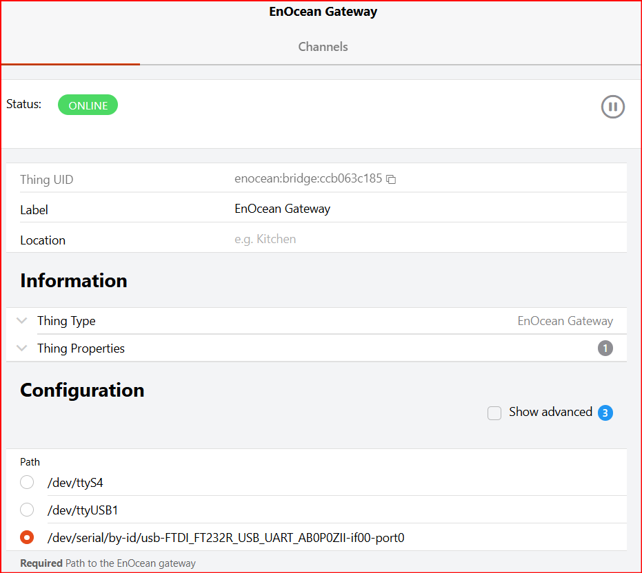

Some more digging (and asking Claude), taught me that there’s a safe way: namely via the “device id”:
erik@MinipcLG2:/var/log/openhab$ ls -l /dev/serial/by-id/
totaal 0
lrwxrwxrwx 1 root root 13 jul 30 19:48 usb-FTDI_FT232R_USB_UART_AB0P0ZII-if00-port0 -> ../../ttyUSB1

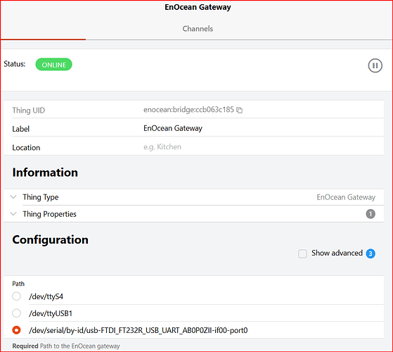

And that appears to be the third option on my list:
So I assume I fixed the problem forever for my setup.
