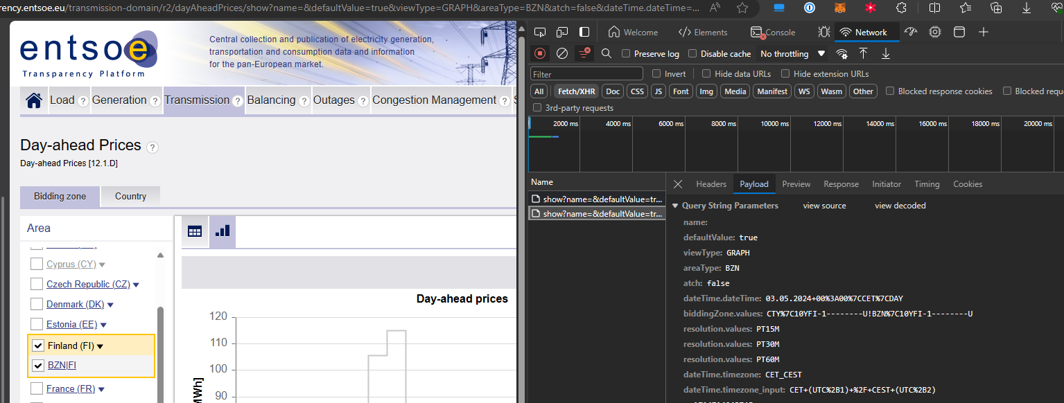

In my network tab when loading this data on https://transparency.entsoe.eu/ for Finland and Norway this shows (see biddingZone.values):
Finland
biddingZone.values: CTY|10YFI-1--------U!BZN|10YFI-1--------U

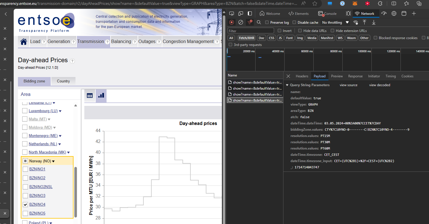

Norway
biddingZone.values: CTY|10YNO-0--------C!BZN|10YNO-4--------9
Do you happen to know @gitMiguel ?
Forked the binding and changed the zones, then it worked… Will it be ok if I change some minor stuff in the forked version and makes a pull request for openHAB addons?

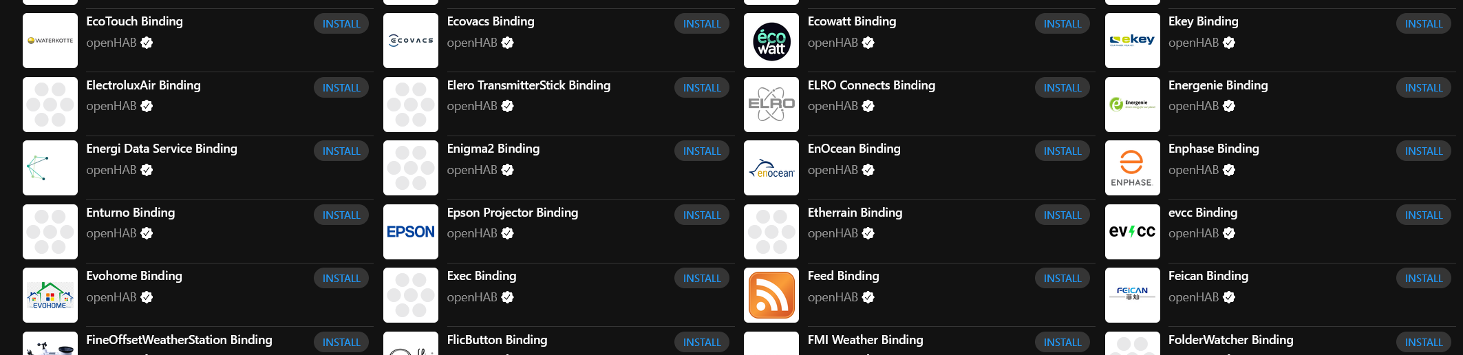

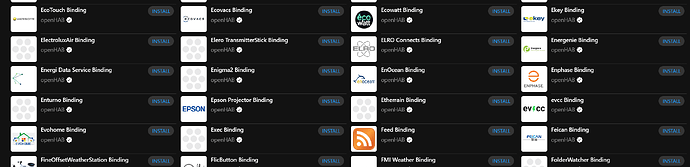

Since June 10th the binding seems to have disappeared. What happened?
what do you mean by “disappear” ? Using the links in the original post to download still works.
I mean from my list of bindings in OpenHab. Should it not be here:
It was in this list, I installede it and it worked perfectly, until all of a sudden it just stopped and said ERROR:HANDLER in my list of things.
