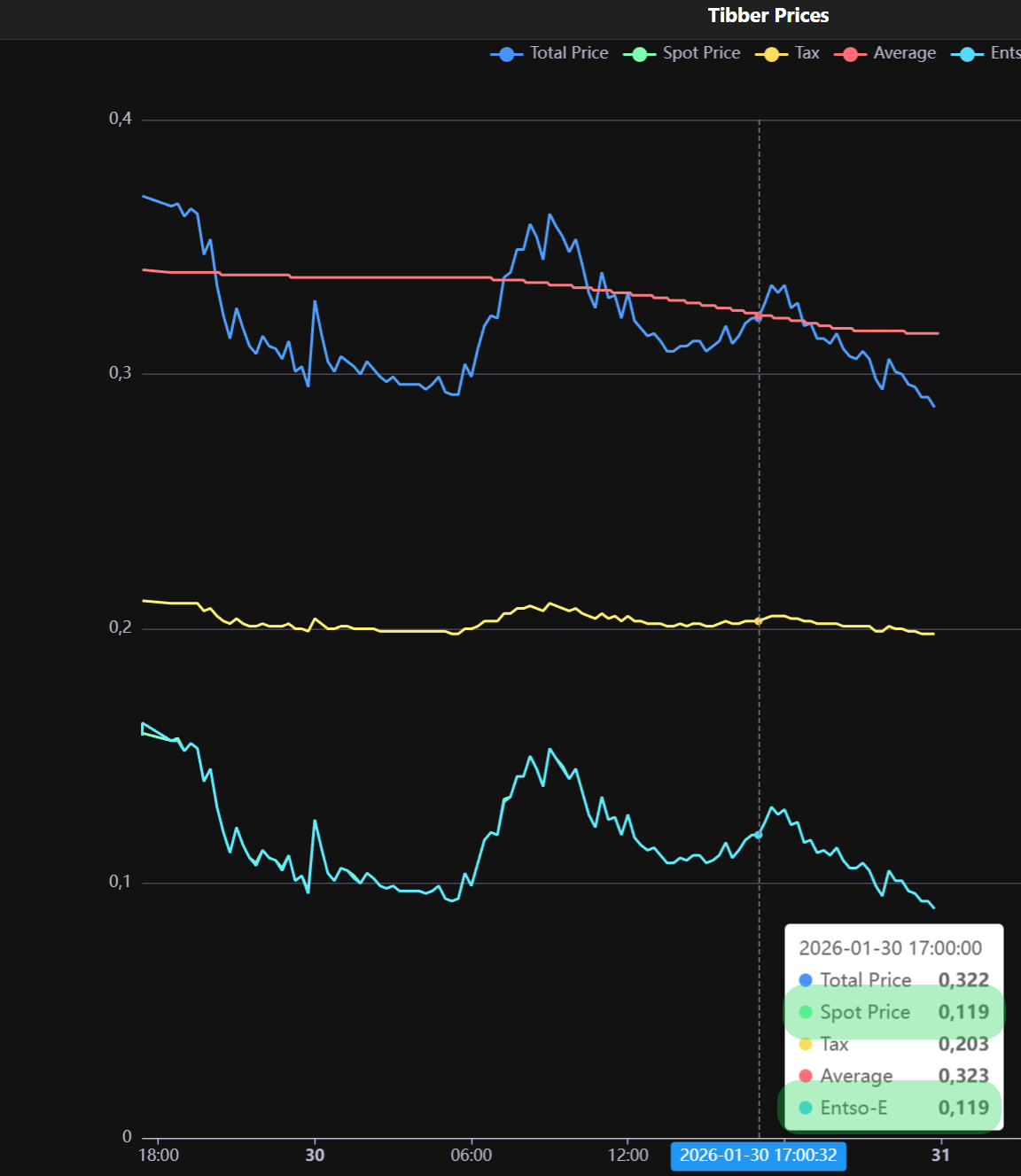

I double checked this with my Tibber spot prices (without tax and additional expenses) and they are matching!

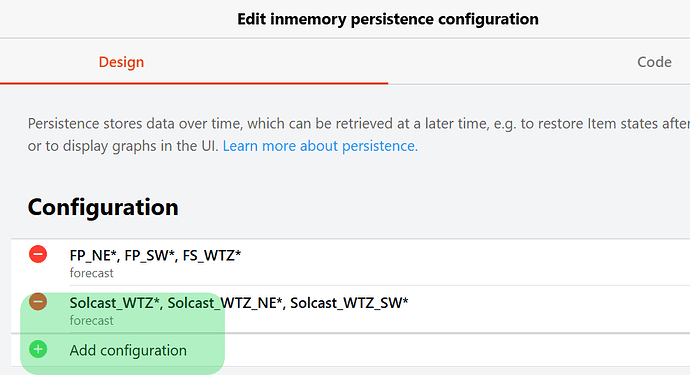

For checking install inmemory persistence and add a new configuration with strategy forecast and add the entsoe item to it.
Disable and enable entsoe thing to force an update and after a while the value will appear.

I added the item to a group “(inmemory)” and have a stragtegie for items "inmemory* : strategy = everyChange, forecast”

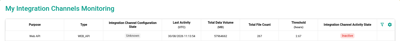

Something caught my eye while I was in transparency platform:
To me “Total Data Volume” looks crazy high. Do you see similarly high values in your account?
Yes, my Monitoring window looks similar.

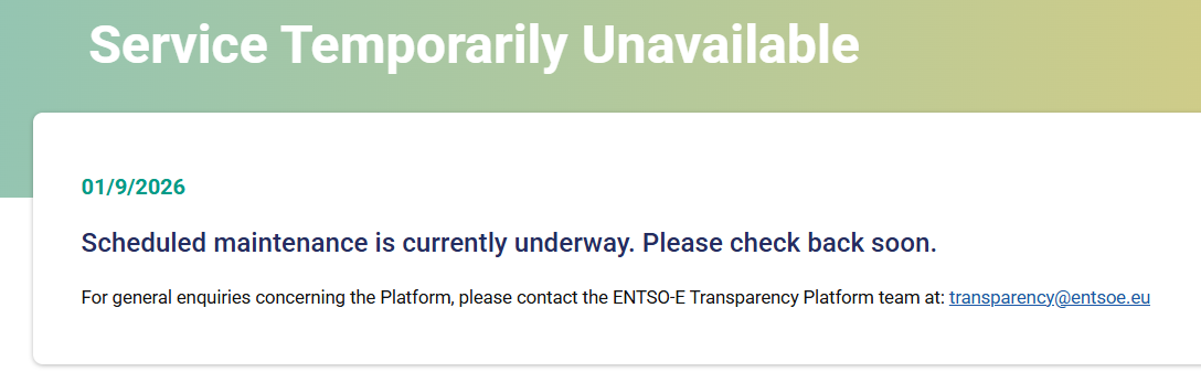

API call result:
Already started yesterday.
EntsoE has a new message from today that the migration of their system was not successful and that they are doing a rollback to the previous version. After that they have to clear the API call backlog. No estimate when up and running.
Thing is online again in my setup :+1:
Entso works for me now.
