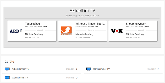

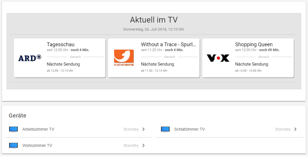

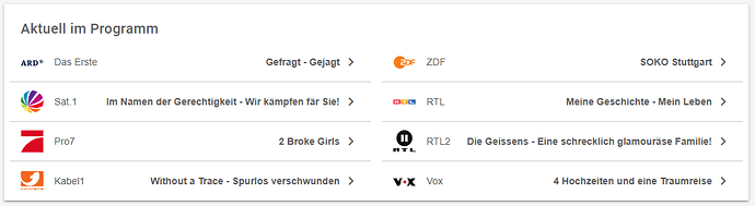

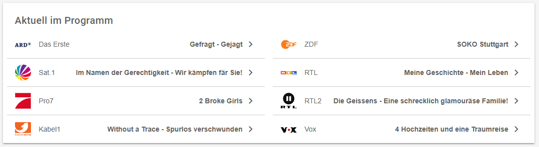

But I agree with @rlkoshak that OH isn´t ideal to handle all this information as an seperate item. Another approach could be to let OH only control the actions like “play channel xy on device”, “record show xy”, “mark show xy as favourite”, so you only need a few items per channel to interact with the epg in OH.
Informations like the show-title, start-end-time could be shown in a webview, like this (very early creation stage, so some parts/infos are missing. :wink: ):
