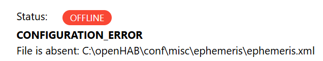

In the Ephemeris binding, this error is displayed

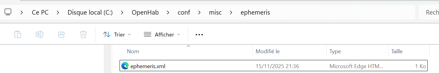

However my file is at the right place, or maybe I have missed something. I’ve checked some posts but I didn’t found the solution yet.
I notice the folder is “OpenHab” in explorer but the error talks about “openHAB”.
Case didn’t used to matter in Windows but it might matter in Java.

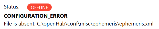

Thanks for the tip, however, same error. I’ve corrected the base path in the wrapper file
set.default.OPENHAB_HOME=C:\\openHab
but the case is ok now.
