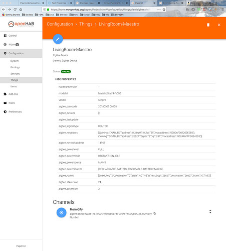

I’m running openhabian 1.4.1 on the openhab snapshot channel, so I’m running 2.4.0-SNAPSHOT. I have a HUSBZB-1, which is (I think) installed properly for Zwave and Zigbee. I have the Ember EM35x Coordinator present and online. I’m trying to connect a Stelpro Maestro thermostat. I was able to have openhab discover the thermostat. The device showed up in the Paper UI inbox and I added the Thing. However, the Maestro item does not show as online when I restart openhab. There is only the ember controller xml file in {USERDATA}/zigbee…no file for the Maestro. I see the error below in the zigbee log. The Paper UI shows this when I look at the properties of the device:
|hardwareVersion |1|
|modelId |MaestroStat»ï§C¤):|
|vendor |Stelpro|
|zigbee_datecode |20180509 00105|
|zigbee_devices |[]|
|zigbee_lastupdate ||
|zigbee_logicaltype |ROUTER|
|zigbee_neighbors |[{"joining":"ENABLED","address":"0","depth":"0","lqi":"49","macaddress":"000D6F001200E2E0"}]|
|zigbee_networkaddress |33805|
|zigbee_powerlevel |FULL|
|zigbee_powermode |RECEIVER_ON_IDLE|
|zigbee_powersource |MAINS|
|zigbee_powersources |[MAINS, DISPOSABLE_BATTERY, RECHARGABLE_BATTERY]|
|zigbee_routes |[{"next_hop":"0","destination":"0","state":"ACTIVE"}]|
|zigbee_stkversion |24|
|zigbee_zclversion |2|
