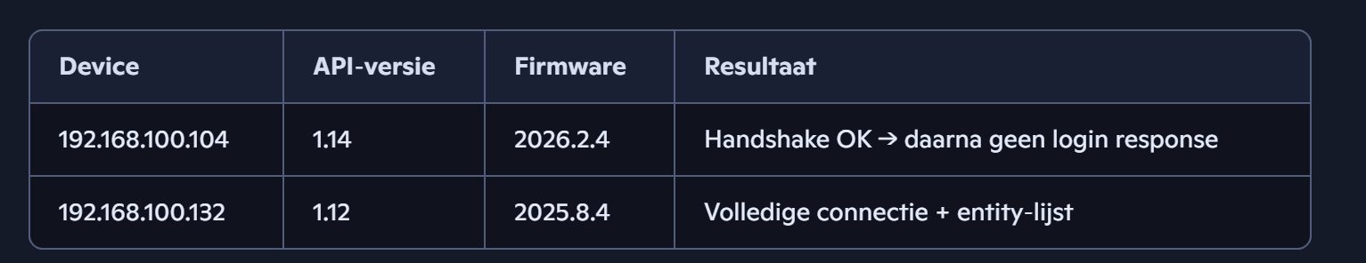

The first Apollo MSR-2 does not response to ConnectRequest but the second one is working fine. This are the versions.
Is there a version of no.seime.openhab.binding.esphome-4.1.0-SNAPSHOT.jar what can work with API version 1.14. Maybe the latest one but I can’t install that version. There my problem and search started
The binding supports the latest ESPHome version, but possibly not your eldest ESPHome device as there was a breaking change in the ESPHome protocol starting with version 2025.10. If you cannot make that device connect, you should upgrade it.
I run all my sensors on the same ESPHome version (2026.2.4), so if you are running the lastest version of the binding (which you always should), they will work.
