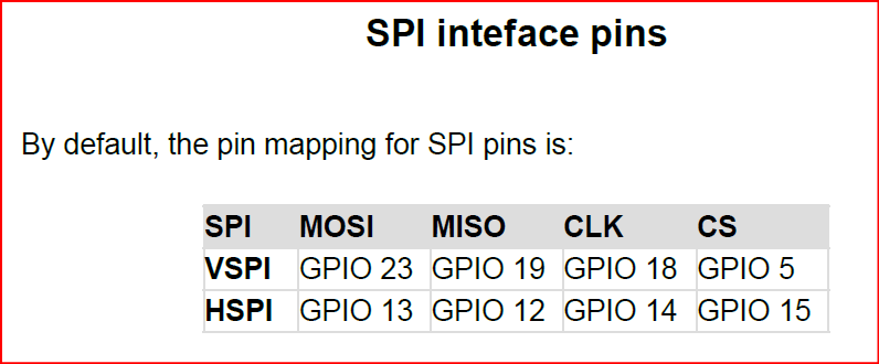

In addition to this, I want to link a MAX6675 temperature sensor to the same ESP32 board I want to connect the relay module to (MAX6675 Temperatur Sensor mit Sonde K-Typ und Jumper Wire für Raspberr). And this is what I found about that module:
  1. a Russian guide which talks about MISO, CLK and CS
  2. a guide in English which does the same, but with other pins
  3. It of course needs power. My ESP32 board has a 5 V output, a 3.3 V output and three GND pins… The temperature sensor should work with 3.3 V, but does it matter which GND pin I use? I can’t imagine the 5 V and 3.3 V on the same GND is okay…? But then again, why are there three GND pins, and isn’t it clear which one should be paired with which Volt out?
Here’s the “pinout” overview from the ESP32 I bought: https://cdn.shopify.com/s/files/1/1509/1638/files/ESP32_DevKit_C_V4_Pinout.pdf?v=1615364529.
I’m in over my head with all the pin categories… If someone who understands more can tell me which pins to use, that would be great. :slight_smile:
Thanks!
Check out MAX6675 K-Type Thermocouple Temperature Sensor - ESPHome - Smart Home Made Simple. many pins will work, and you have many to choose from :grinning_face:.
The Esp can configure to a certain extent which pin on the board does what. Esphome handles this for you based on the yaml file. Many pins can be used for general io (gpio) , but things like the builtin uart(s ) and adc(s) have some limitations.
In general as you have noticed Try to avoid the strapping pins. They might work in a particular case or not. Depends on what you connect them to.
All gnd pins are connected, does not matter which one you use.
Happy hacking!
Isn’t GPIO5 regarded a strapping pin, according to the documentation I quoted? But it’s also the SS pin. That seems like a conflict? :slight_smile:
Yes, so just pick another unused one that is gpio, update the yaml and move the wire to the corresponding pin😀.
Dx, Sx, GPOIx are all just aliases for physical pins on each particular board, so ensure you have used the correct board identifier whenever you create a new setup (seems like you have).
Using a strapping pin for reading a sensor might work just fine as the communication Protocol is set up afterwards, but for an actuator on a direct gpio signal it might trigger some physical activity during power up.
Remember that Esphome supports different boards and processors, so which pins to use isnt fixed at all and depends on your use case. My personal experience is to always to connect hardware items with DuPont wires first and verify everything works with the Esphome configuration before I heat up the soldering iron :sweat_smile:.
But if GPIO5 is the SS, didn’t the board developer envision this conflict? :thinking:
But you’re saying any pin can be the SS pin? There’s no hardware difference?
Strapping pins control boot modes such as flashing etc, but again; (most) pin functionality can be reprogrammed inside the esp32 chip itself. Think of it like an internal switch board . Just pick a non strapping pin if you can.
Google esp32 strapping pins for info on each one
Arne

… even though the documentation of my ESP32 says stuff like this:
… and gives thin pin scheme:
Correct?
what happens if you try it? i.o.w.: just plug it in, the biggest problem you can get is an error message :wink:
