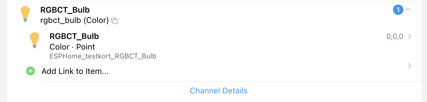

There are some shortcomings to the light support, but your configuration should at least give you a channel where you can control the color;
There should probably be more than 1 (plus the -effects channel), but I’ve only got a simple 24 led ring to test with.

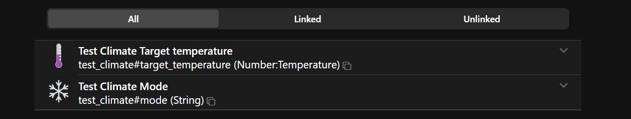

I have added a climate device. In OpenHAB I am only seeing 2 channels enumerated. Are climate devices fully supported? Or do I have an error in my climate device setup?
I use a panasonic climate device and it shows with all channels I would have expected like target, current, mode, fan, swing,..
I have 5 aircons on 2 different Esphome aircon components, all working great.
Feel free to send me debug Level logs starting from before you enable the device.
Also pless send the Esphome config as it makes it possible to reproduce.
