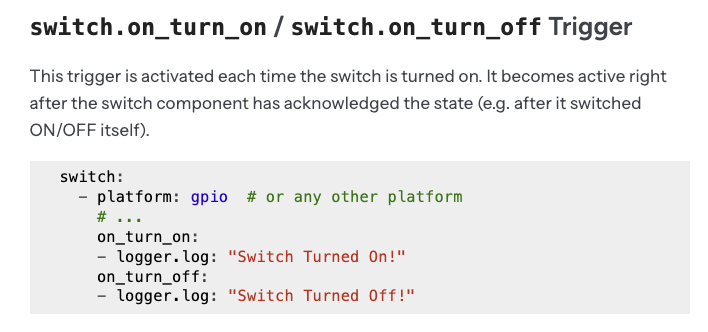

OK, in your original post ESPHome binding for the Native API [4.0.0;6.0.0) - #300 by ErikDB you refer to an ESP device called haard-eetkamer, while in the latest you refer to haard-salon. Confusing since your logs contains statements from both devices.
It is clear from the log that haard-salon switch winter_OFF receives the command and sends state responses for IN3, but not for winter_OFF.
Guessing section:
I see that you use turn_on_action, but you don’t publish an ON state when the command is received, hence when you in the last line requests the state to change to OFF, no update is sent from the device as winter_OFF already (and probably always is) in state OFF.
CleanShot 2024-11-05 at 08.56.50
Maybe what you were actually looking for is
beer_me
Happy hacking!
Apologies. They’re identical twins. :slight_smile:
The rest of your help did the trick! Hooray!
