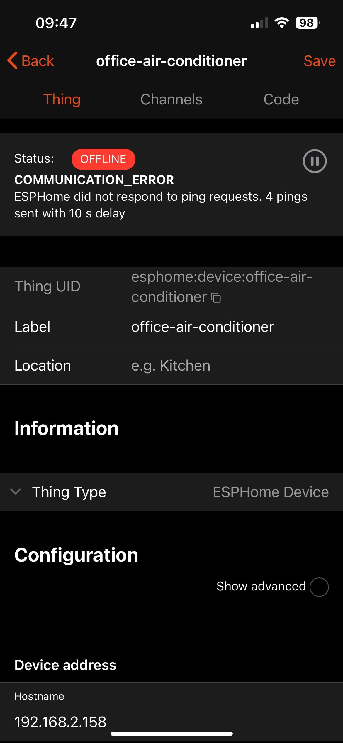

I am still getting the following error message:
[REMOVEMEWHENADDINGirrf] Ping responses lacking. Waited 6 times 30s, total of 180s. Last pong received at 2025-05-11T10:30:55.137826937Z. Assuming connection lost and disconnecting
How can I fix this?
Running the latest version?
running 4.3.5 of OH and ESPhome add-on Updated At 12. march 2025 09:36
This one is really hard to debug because I don’t see this myself at all (other connection issues related to a crowded radio environment however - but always the same 3 devices that are acting up).
There are a few things you can try; see first and third FAQ entry: GitHub - seime/openhab-esphome: ESPHome native API implementation for openHAB binding
I’m also sending you a new version in a PM where I’ve rewritten the thread handling just to see whether it helps or not. One caveat is that I’ve removed support for plaintext password which has been deprecated for a year or so. Hopefully no-one is using it anyways. But I’m not ready to publish yet.
Please enable DEBUG logs and send to me when you see the problem. If I have nothing to investigate it is really hard to figure out the culprit.

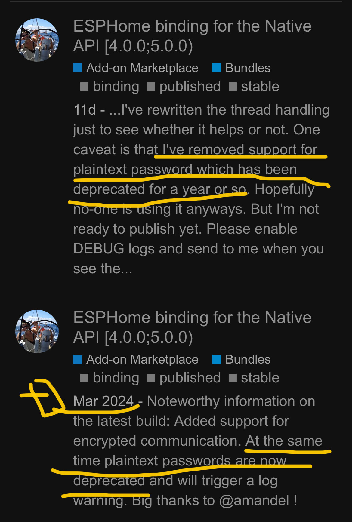

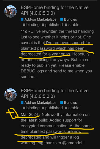

Is it possible to install an older version of this binding? It was working for me before the latest OpenHAB update.
I have 4x Konnected Panel Pros (https://konnected.io/), which connect using the ESPHome API without an API key.
There is a way to add them to ESPHome, but it’s not working for me and adds a layer of unnecessary complexity even if I can get it working.
Why is the API encryption key required? Why can’t it be like it was before?
If I downgrade openHAB, will this binding downgrade too and go back to the way it was until I can get my device sorted?
Or is there a jar file of an older version of this binding that will work in the latest OH?
Can you update them wirelessly?
It’s complicated. It’s a standalone product that happens to use ESPHome firmware and api. It works standalone with it’s app for changing settings and setup, this is why it has worked for me until now, but the app has no api settings. There is a way to adopt them into ESPHome and customise the firmware, but for some reason they aren’t being discovered by ESPHome, so I need to trouble shoot all of that first.
I didn’t see this as a breaking change in the OH release notes, only in this thread. Either I missed it or it wasn’t there.
Nah we had ample warning. The problem I would say is that your setup is non standard. And as we frequently discover, non standard setups eventually become headaches
There was only warning if you were following this thread. I had no reason to need this thread until now.

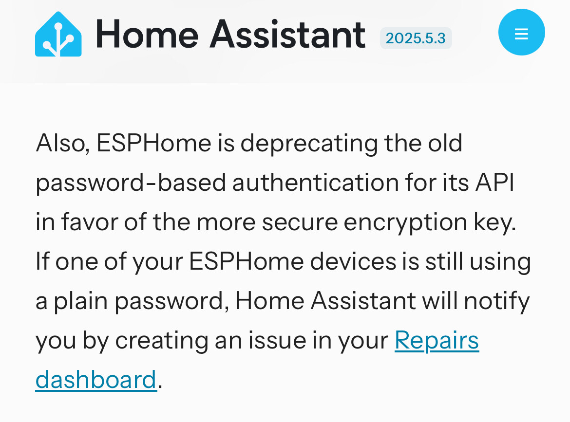

I may not be explaining myself properly. Let me try again.
This binding connects to devices that use a firmware called esphome.
Esphome is part of nabu casa / home assistant.
The ā€œownersā€ informed the community here:
About this coming change in 2023. Changes to esphome also affect bindings because if they remove features we also lose them.
So… if you’re not following esphome news, you get surprises like this :slight_smile:
ok, well we’re here now, whether it’s my fault or not.
I tried downgrading OH as far as I could without breaking even more stuff, but it is still using the newest ESPHome binding. Is there a jar of the last version of the ESPHome binding?
