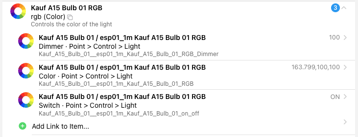

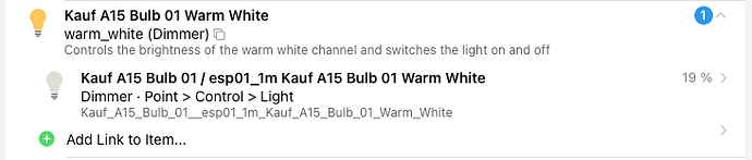

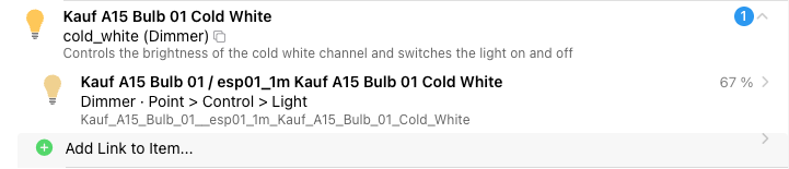

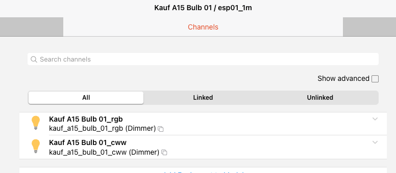

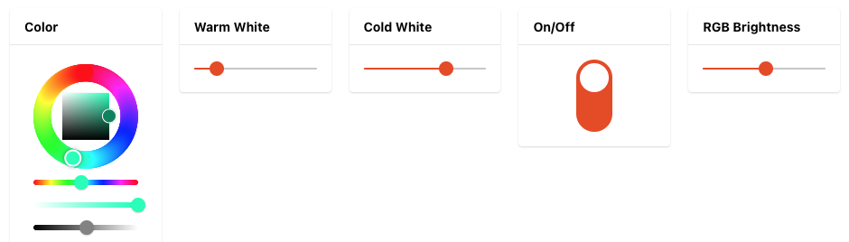

Finally got my dev environment working, or at least working enough to start adding some RGB/Color Temp functionality to the Light type…
Sadly I only have an hour or two here and there to work on it throughout an average week, so it may be a while before I have a pull request ready, but I’m working on it…
I also have a single pixel rgb led working with esphome :slight_smile: everything works fine. Both color and brightness. I’m using it to show what mode the ac is on.
You might want to take a peek at https://github.com/openhab/openhab-core/pull/4995 to see whether this new feature (not yet merged) could make light handling easier/more consistent with how OH (in the future) handles the various types of bulbs/lights out there.
That does look like a very handy feature! Keeping track of those things more painful than I anticipated.
Nonetheless, after a few late-night coding sessions ,lots of coffee, and lots of debug logging, I have gotten to the point where my test RGBWW (RGB + Warm White + Cold White, color_interlock: false) bulb is working correctly (where “correctly” is defined as “with the same controls and behavior as HomeAssistant”):
I may have broken simple on/off lights and/or effects, though :slight_smile: Still some more work to do before I’m ready to submit a PR.
