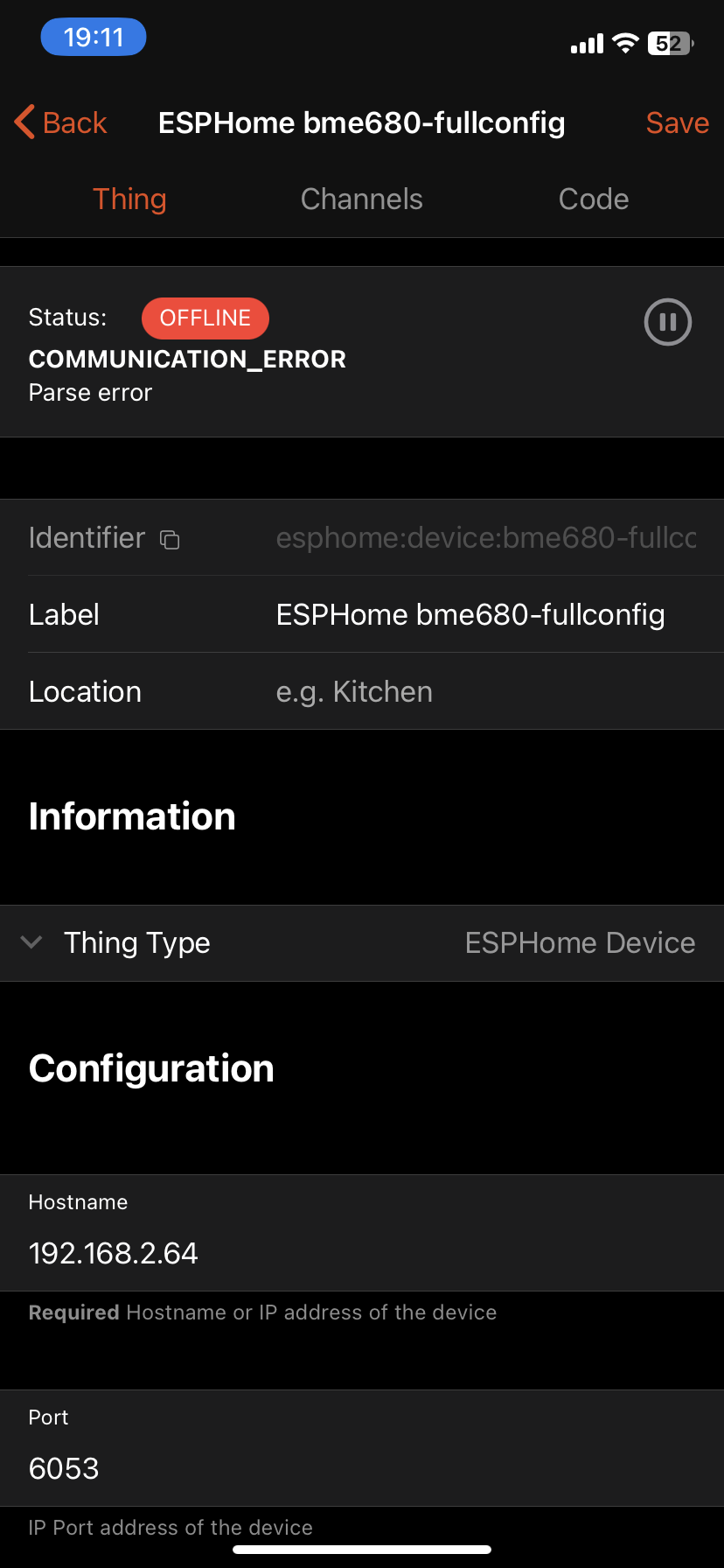

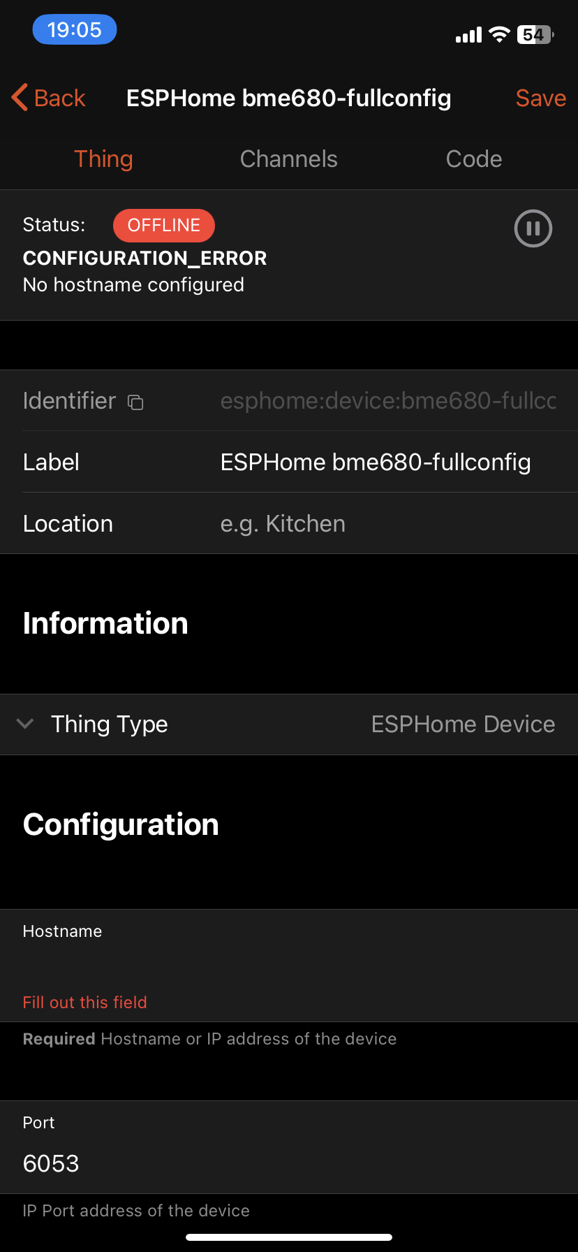

However, the thing created had no IP assigned (the esp device has static IP set, and the esphome container has the variable “use IP” set to true because mDNS refuses to work on my network.).
Once I pointed it to the correct ip I get a parse error.
No other errors. I’m currently only able to use one hand. As soon as I get the second one back I’ll check the logs to see what’s up over there.

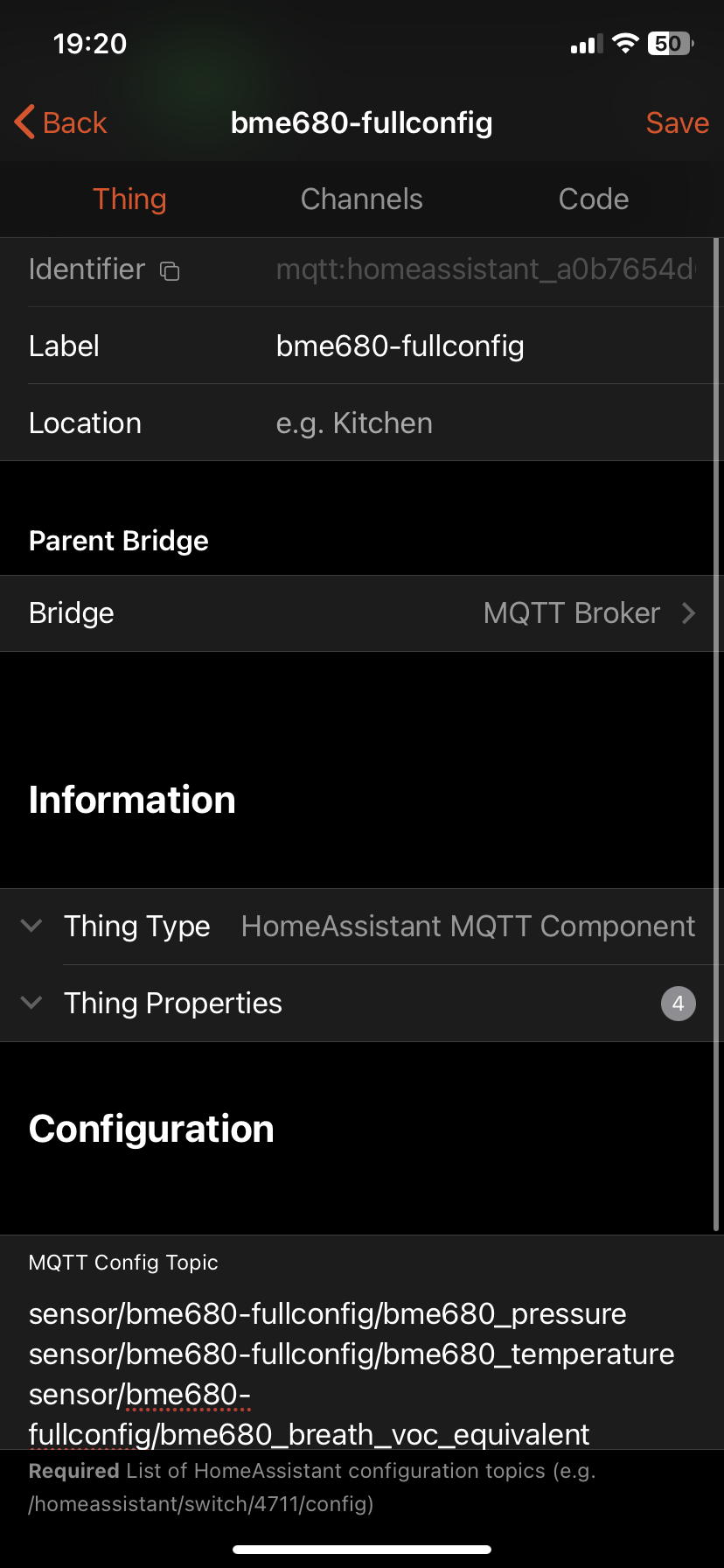

Oh right, I added the mqtt component to the esphome device and the mqtt broker with openHAB homeassistant discovery worked fine:

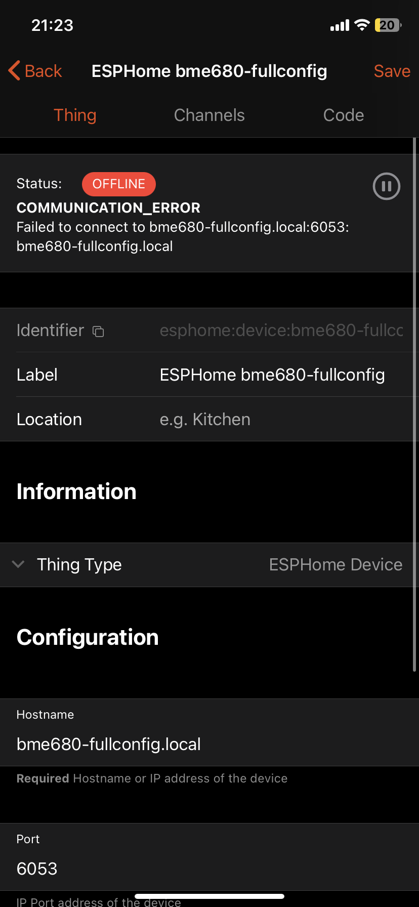

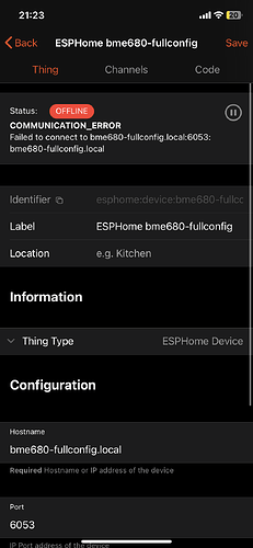

Okay so I went over my network and noticed that igmp was on and mDNS off over on my unifi network. Updated that and now mDNS works. I confirmed it by checking the logs through Wi-Fi:
So that takes care of one problem. But when adding the .local hostname on openHAB i get an error and it seems like it’s looking for the hostname, twice?
Hope the screenshot clarifies what I mean.
Maybe a hint but I seem to be unable to ping the .local addresses from inside the openHAB container, but the IP works. Would it be possible to allow both options??
And once again, sorry for the long post. It’s gotta be a record somewhere xD

After testing with an ESPHome device using api encryption (which is good - but I have not implemented it yet), I get the same error. I’ll see if I can detect encryption being requested by the device and provide a better error message.
Temprorary solution: Use something like
api:
  password: "MyPassword"
and not
api:
  encryption:
    key: <base64 encoded key>
.. when flashing your ESPHome devices.
Regarding mDNS and hostname config; something else is fishy - reported on github: Reverts back to mDNS name · Issue #1 · seime/openhab-esphome · GitHub . Cannot see what the problem is since I have no code to update the thing configuration, only channels and properties. Must dig deeper.
Hope this helps, thanks for testing :slight_smile:

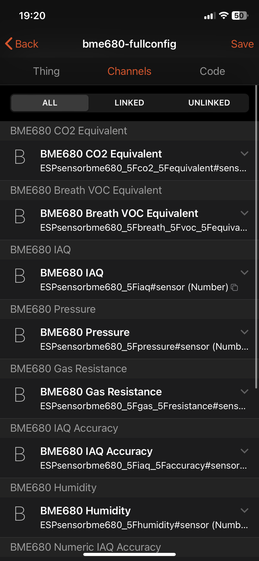

So that’s what you meant! I totally misunderstood you. Got it working now, all channels auto populates too.
The one thing that it would be cool to do was if both the IP and password got auto populated too, but maybe this isn’t possible?

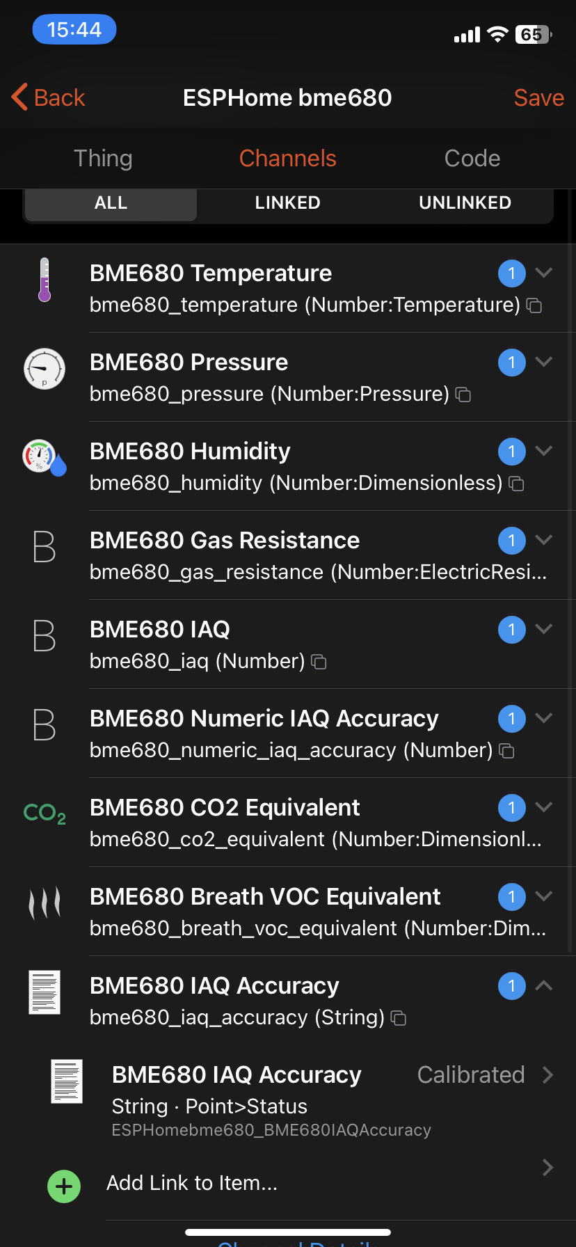

@seime slow and steady clearly getting better :slight_smile:

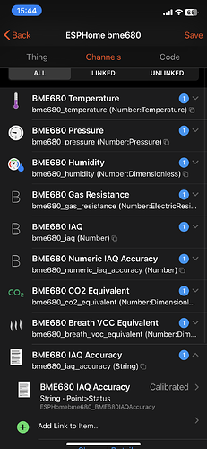

All units auto picked up, linking to old items also worked. Thank you for the text sensor, that was a nice surprise :slight_smile: I made sure to include the calibration status in the screenshot above for you to see :slight_smile:
I checked the logs and I don’t see any errors per se, I think they are just informative notes, but in case they matter I’ll share them as well below.
