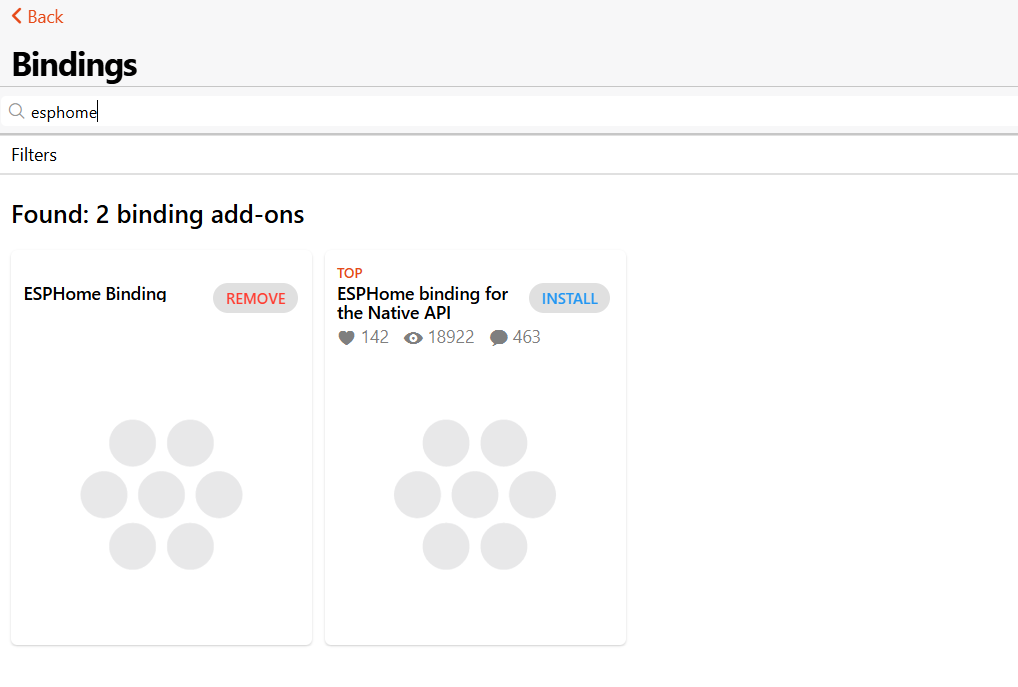

Also check that you don’t have 2 versions of the binding installed, or any (in theory unrelated) other system issues.
erik@MinipcLG2:/usr/share/openhab/addons$ pal
totaal 4556
drwxr-xr-x 2 openhab openhab    4096 okt 19 15:09  ./
drwxr-xr-x 4 openhab openhab    4096 okt 19 15:09  ../
-rw-r--r-- 1 root    root    3854242 aug 25 10:31  no.seime.openhab.binding.esphome-4.1.0-SNAPSHOT.jar
-rw-r--r-- 1 root    root     604682 sep 23 13:07  org.openhab.binding.shelly-5.0.2-SNAPSHOT.jar
-rw-r--r-- 1 root    root     188578 sep 23 13:32 'org.openhab.binding.unifiprotect-4.0.0-SNAPSHOT-2025-09-23.2 - frame logging.jar'
-rw-r--r-- 1 openhab openhab      70 okt 17 08:16  README
Not that I know of…

This isn’t the latest one! It appears you deleted the new one and kept the old one, ref ESPHome binding for the Native API [4.0.0;6.0.0) - #447 by seime
Delete the file and grab the latest from OP (or install from marketplace). The latest one is from medio October, yours appear to be from August.
Based on the logs it appears that you’re suffering due to this ESPHome change: Fix connection time out when device does not support authentication by ccutrer · Pull Request #58 · seime/openhab-esphome · GitHub
:dotted_line_face:
With the latest jar, I ran a manual scan before manually adding the device. It wasn’t discovered, but that’s maybe because I had already created a thing that IP address and device ID in the past? Anyway, now the (manually added)device comes ONLINE and works.
What a stupid mistake… Terrible that I’ve wasted hours of others’ and my time…

  1. Could you provide the output of `openhab-cli` command `bundle:list |grep ESPHome’ ?
  2. Please set the ESPHome binding logs to DEBUG
  3. Please that the ESPHome version of the “old” ESP
  4. Please provide OH channel→item mapping for both West and East devices
