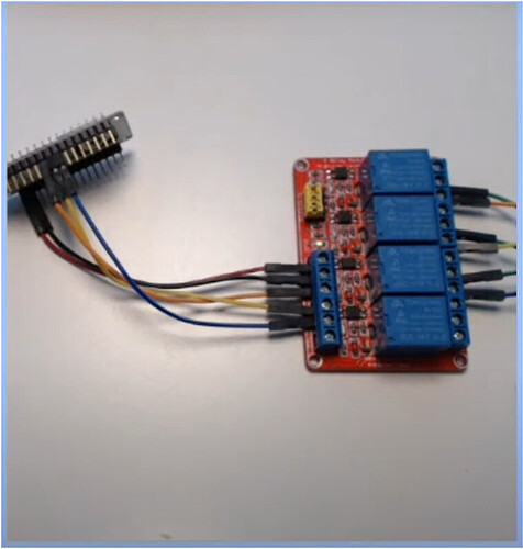

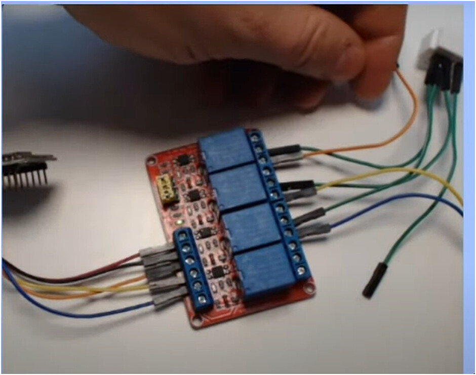

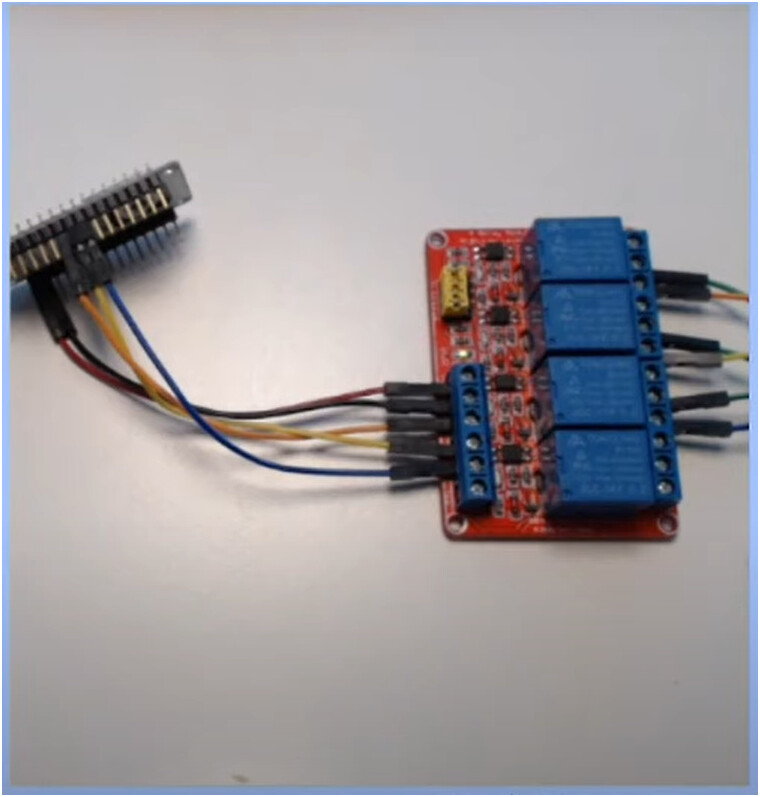

I know nothing about hardware, but following Pieter Brinkman’s guide, I identified these things as ‘shop targets’:
Does that look like a good choice? Brinkman also recommends “breadboards”, but I don’t understand what they add… I also assume the “dupont cables” make soldering unnecessary?
now there is a browser (web) based version I think
https://web.esphome.io/
There are no drawbacks to use the normal python venv.
Breadboards are good because you can just connect everything with the wires and try it out.
Once you got everything working you solder it together to make a permanent connection.
I would not use the esp ESP8266 but the ESP32. It’s a little bit more expensive but has a much better wifi module and doesn’t require as many workarounds as the ESP8266. It also has much more performance which makes it all in all a much more future proof solution. The only change you have to to is to configure ESP32, otherwise it’s a direct replacement.
Like this one: https://www.amazon.com.be/-/nl/IOT-wifi-module-krachtige-wifi-module-draadloze-MP3-audio-codering/dp/B0956LY93Q?
But it doesn’t look like there’s any soldering to do…? Aren’t these ‘dupont cables’ what connects everything? (And they don’t seem to require soldering?)
Screenshots from Brinkman’s guide video:
