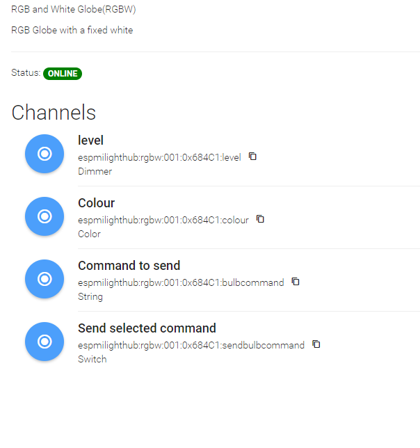

I can’t see this channel in PaperUI for any of my RGBW things:
Not sure what I could have done wrong - there is not even the ‘show more’ button that you sometimes see hiding additional channels. Is this one missing for the RGBW thing?
When I trigger a command from OH (via the sitemap) I am still getting the received update [] rule triggering every time.
