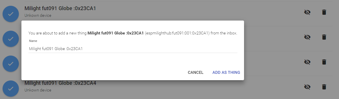

However Iâm unable to set up a T1 Wall Controller (only has level). In MQTT and PaperUI The controller shows up as âfut091â. When I add the controller as a thing through my config file, it will still be discovered in PaperUI (it does not recognize the thing as it does with the T3 rgbw controller). Because of this neither my items nor my rules using the T1 controller work.
I saw that there is support for the fut089 (should be B2 & T2). Maybe you can add support for the fut091 (B1 & T1) the same way?

This is how it shows up in Paper UI:
This is my bridge thing with the working rgbw (T4) controller and the non working fut091 (T1) controller:
