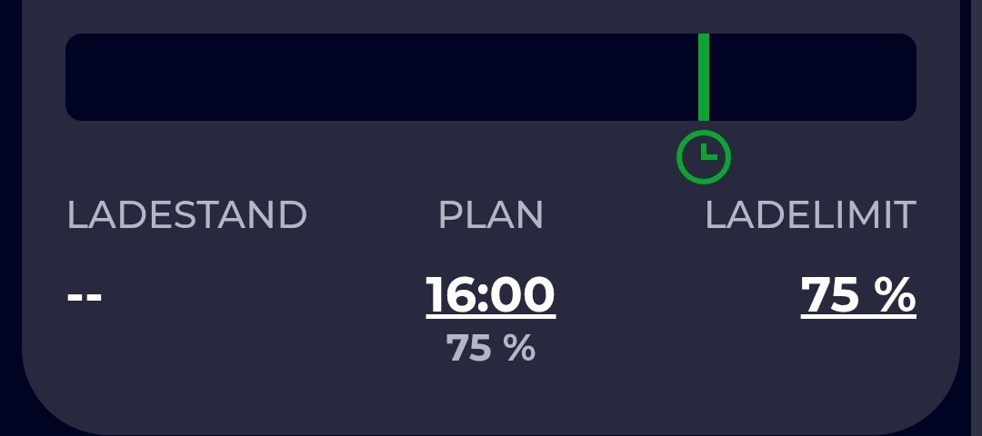

I need your advice again. There are two Channels loadpoint-effective-limit-soc and loadpoint-limit-soc. Both linked to Items of type Number:Dimensionless.
The state of the first one always has the same state as shown in the evcc UI for SoC limit (“Ladelimit”) which you can see in the following screenshot.
The state of the second one is according to my observations always UnDefType or 0 %. But it can handle commands which will be sent to the evcc API and change the SoC limit (“Ladelimit”) for the active session.
Do you have any idea why there are two Channels for the SoC limit? One for the state and one to handle commands?
Currently it is not comfortable to use it for a slider card in Main UI. The card is not capable of separating between Item for displaying the State and another Item for handling the Commands.
I, too, stumbled across it and use loadpoint-effective-limit-soc
Cannot explain the difference though. cc: @weymann

As far as I know the effective soc limit will be set either by user, by plan or by vehicle. So whatever is active / the minimum will become the effective soc limit.
Limit soc should only be 0 or UNDEF if no car is connected to charging point. Otherwise the user defined value should be displayed.
