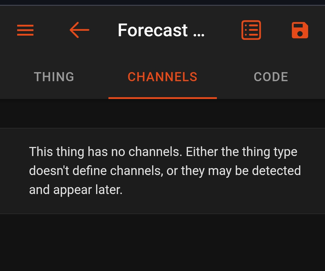

I tried to add the forecast Things for “grid” and “feeding” prices today. Unfortunately the discovered Things do not have any Channels. Do I have to add them manually?
version: 1
things:
  evcc:forecast:api:grid:
    bridge: evcc:server:api
    label: Forecast Grid
      subType: grid
No, they should be automatically added when the forecasts has been detected within the API response.
Hm, for “solar” it is working. for the other it does not. How can I find out what is wrong?
My response from evcc API looks very similar to what is added to the bindings test code.
Do you got any messages in the log for this binding?
Only when setting log level to DEBUG or TRACE. But nothing related to the forecast stuff except for the EvccDiscoveryService.
