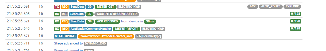

No, as I said in my first post kwh works fine it’s just watts.
Also what you pasted implies the controller polled the device, I am expecting every 30 seconds for the device to transmit to the controller the watts - not relying on polling.
