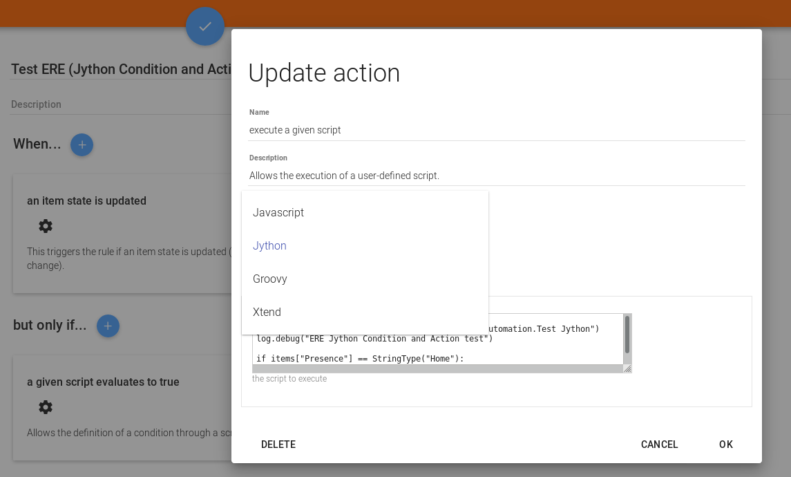

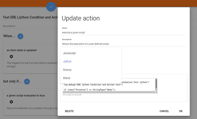

Hey @rlkoshak, good news… I’ve got Jython and Groovy scripted actions and conditions working! I’m holding up putting in the PR until ESH is migrated.
Great news. Will the PR also contain what ever is requires so we can select the other languages when creating the Action through PaperUI? Right now the drop down list only has JavaScript.
Presumably Jython and Groovy will need to be installed before those languages can work, or will the PR also include that? It seems reasonable to me that they ship with OH by default from an NGRE perspective. But I don’t know the full implications of doing that. I suspect the reason JavaScript ā€œshipsā€ is because Nashorn is part of the JRE by default.

They will need to be manually installed. There is not any way, currently, to restrict the list to languages supported by the system.
I stongly agree. Automating installation of the languages will come in another PR. If I do it, it may take a while, but I think JSR223 bundles are important to have.
You got it… it’s already in there!
