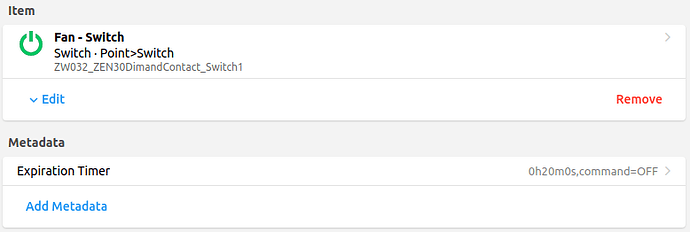

I am using a Zwave wallswitch, with the switch connected to a bathroom fan. I have the Expire Metadata set for it with the following code, however it does not work as expected:
> value: 0h20m0s,command=OFF
> config: {}
Screen snip:
 ![image](https://community-openhab-org.s3.dualstack.eu-central-1.amazonaws.com/original/3X/e/7/e755898088a7038ad5047109ef9917753a8f697f.png)
I can use this same item but set the Expire to 2 minutes, 3 minutes, 5 minutes, 10 minutes and it works properly. But when it is set to 20 minutes it fails to complete and turn the fan off. Also have set it for 30 minutes and same failure.
Is there any way to see if the Expire timer is activated, and/or what its remaining time is?

Hi Craig,
just a quick guess: Remove the “0h .. 0s” in the expire duration and see if that makes it work.
I have/had a few items that use/d expire times in your time range and they all work/ed without a problem.

**Author:** ![Craigers](https://community.openhab.org/user_avatar/community.openhab.org/craigers/32/116508_2.png) [@Craigers](https://community.openhab.org/u/Craigers)\
**Post date:** [January 18, 2021, 11:24pm UTC](https://community.openhab.org/t/expire-timer-does-not-always-work/114568/4 "2021-01-18T23:24:23Z")
</div>
Thanks Lars and rossko57.
I cut the command to only contain “20m”, however as soon as I saved it, the 0h and 0s were added back on. I’m using the GUI for all editing and configuration.
I’ll watch the switch item to see if any updates are sent. Thanks for the hint if I may need to implement some rules for Expire functionality.
