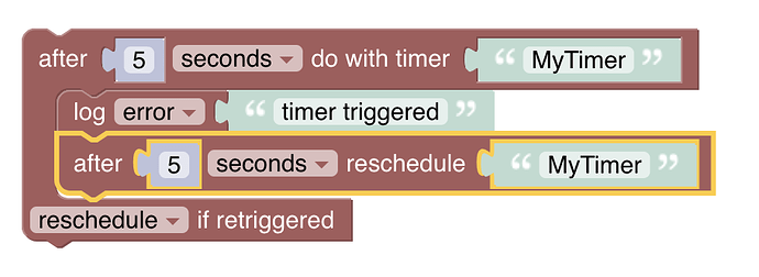

Yes I noticed too but don’t have an explanation. Maybe blocks with mutations simply cannot be put as shadow blocks, or maybe it’s possible to hide the mutation “cog” button so the shadow block is an empty dictionary that you can’t change unless by dragging a real block. Otherwise I’m not hostile to the idea of making it a real block, it’s contrary to the “norm” but at least it would work.
What about something like
if (typeof this.timers['MyTimer'] === 'undefined' || this.timers['MyTimers'].hasTerminated()) {
I suspect the rationale was also to avoid keeping references to terminated timer instances indefinitely in memory causing them to never be GC’ed, but I’m not sure either setting them to undefined would do that.
And there’s also the logic flaw that the “timer has terminated” block
which generates code like
typeof this.timers['MyTimer'] !== 'undefined' && this.timers['MyTimer'].hasTerminated();
is pretty much useless: it would never return true - either the timer is not set, or pending, or running, or has effectively terminated and thus unset again.
I’m not sure either. One would have to look at the scheduler itself to see how well it cleans up after itself.
That would certainly be a little more fool proof I think. Indeed the the timers would never be GC’d but I can’t imagine one would have so many stale timers hanging about where that would make a difference. My assumption is that the scheduler that handles the timers would be smart enough to clean up terminated timers so it should only be the reference in the rule that would keep it from being GC’d. But that’s an assumption and not actual knowledge.
Changing to a check like that would let us eliminate the setting of the timer back to undefined automatically at the minor expense of some extra memory usage.

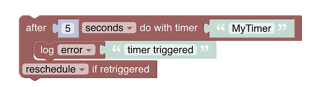

So for this
the result would become
// Change LINE 1
1 if (typeof this.timers['MyTimer'] !== 'undefined' && this.timers['MyTimer'].hasTerminated()) {
2 this.timers['MyTimer'] = scriptExecution.createTimer(zdt.now().plusSeconds(5), function () {
3    logger.error('timer triggered');
4    if (typeof this.timers['MyTimer'] !== 'undefined') {
5       this.timers['MyTimer'].reschedule(zdt.now().plusSeconds(5));
6    }
7    // this.timers['MyTimer'] = undefined; <= take out this line
8  })
9 } else {
10  this.timers['MyTimer'].reschedule(zonedDateTime.now().plusSeconds(5));
11}
or simplified
the code would be as follows
// change LINE 1
4   // this.timers['MyTimer'] = undefined;  // Take this out
5  })
6 } else {
7 this.timers['MyTimer'].reschedule(zonedDateTime.now().plusSeconds(5));
8 }
Note that I haven’t tried that out yet (but I sure will as soon as you confirm)

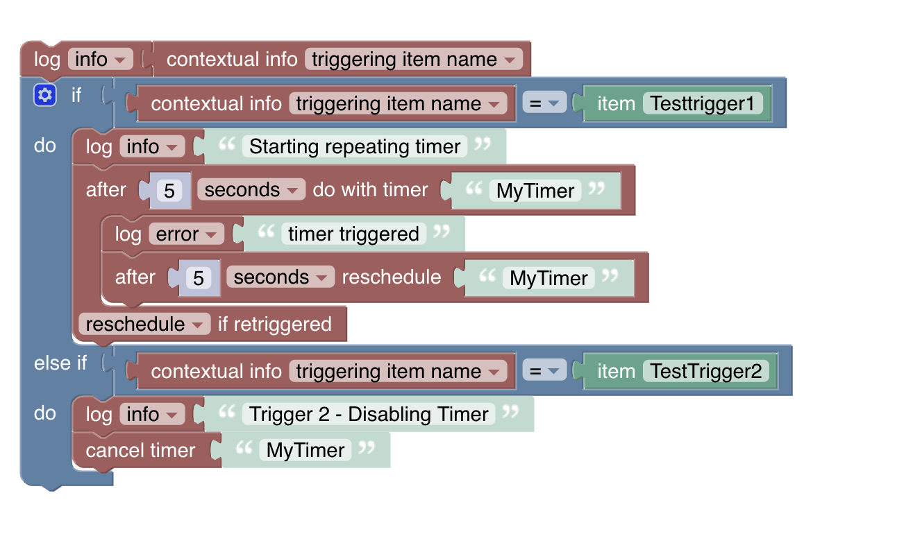

I can confirm it works now as expected. This is how I tested it (for the curious, I used two different trigger items and I distinguish those with the new block that retrieves event information, i.e. in this case the event item’s name):

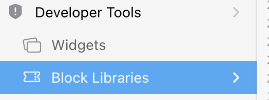

I saw you working on the new blocklib (Block Libraries - initial implementation (#1225))
which refers in its editor to “Tutorial: How To Write Block Libraries - Tutorials & Examples - openHAB Community”.
I checked the latest openhab-docs if I find something there but couldn’t. Have you written something there already so that I can start learning about it?
The link works now!
It points to:
Thanks for the writeup, it works now.

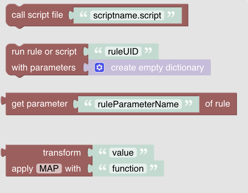

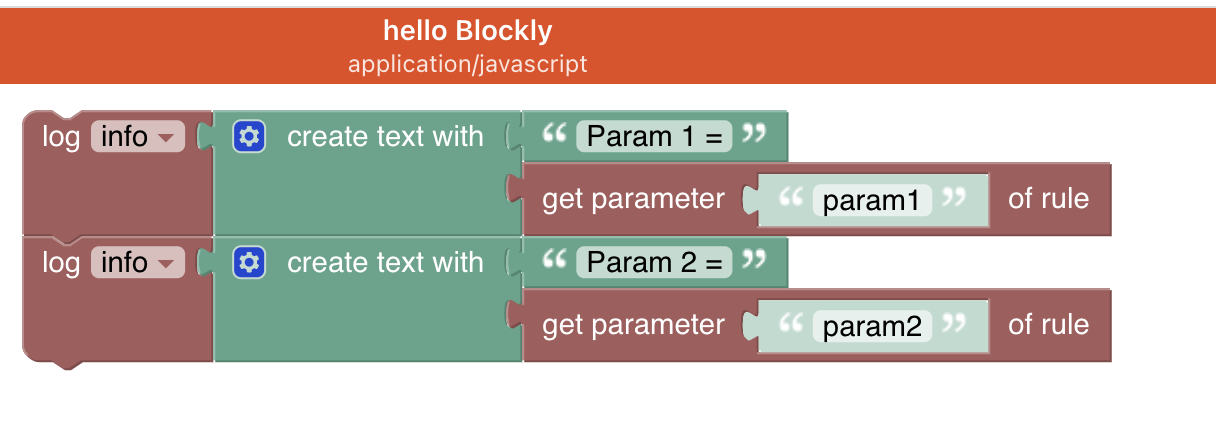

can you do me a favor and merge this last PR. It is a small extension to allow retrieving rules parameters within a script that was written with blocklies. This concludes the blockly “Run & Process” section.
Here is how it can be used when having provided it via a script call as shown in here
The PR is pretty small and should be straight forward
