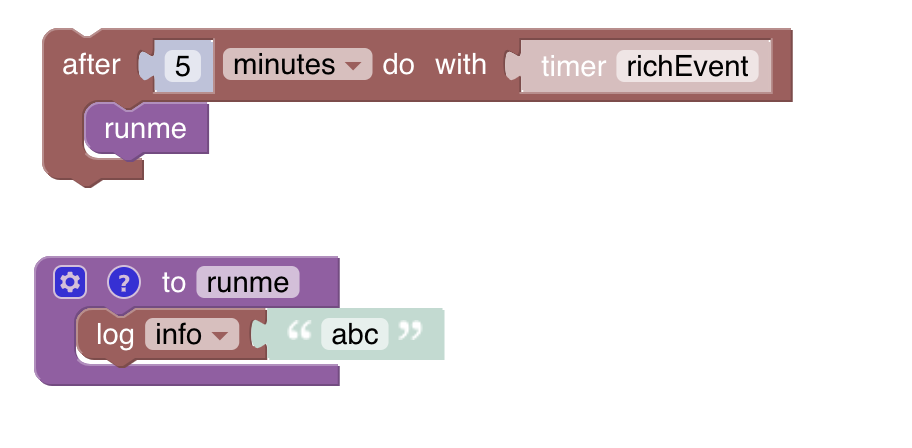

1st example: this.tm.check("richEvent", "5m", runme); Call runme after five minutes.
If called and the timer exists cancel the timer
producing
function runme() {
  logger.info('abc')
if (this.timers['richEvent'] === null) {
	this.timers['richEvent'] = scriptExecution.createTimer(zonedDateTime.now().plusMinutes(5), function(){
	  runme();

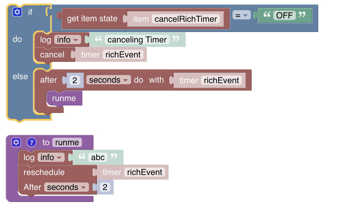

2nd example: this.tm.check(“richEvent”, “5m”, runme, true);`
Call runme after five minutes. If called and the timer exists, reschedule it for five minutes
  • I changed the time to 5 seconds to allow easier testing
  • Note that the rescheduling happens over and over again. If you didn’t want that put the rescheduling to the upper block
  • I added a manual cancelation possibility via a switch to have a chance to “kill” the rescheduling timer.
function runme() {
  logger.info('abc')
  this.timers['richEvent'].reschedule(zonedDateTime.now().plusSeconds(2))
if (itemRegistry.getItem('cancelRichTimer').getState() == 'OFF') {
  logger.info('canceling Timer')
  if (this.timers['richEvent'] !== null) { this.timers['richEvent'].cancel()}
} else {
  	this.timers['richEvent'] = scriptExecution.createTimer(zonedDateTime.now().plusSeconds(2), function(){
  	  runme();

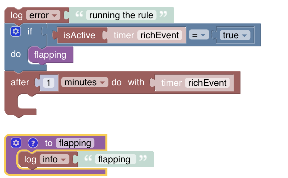

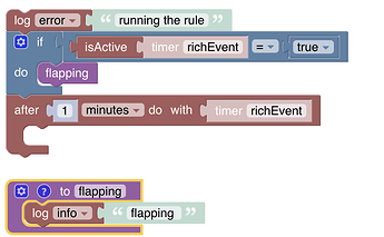

3rd example:
this.tm.check(event.itemName, “1m”, null, false, flapping);
Create a timer for five minutes. Do nothing if the timer expires. If called again when the timer already exists call flapping. Do not reschedule
  • the empty run bracket may look weird but it actually creates a noop-function like in your code
function flapping() {
  logger.info('flapping ')
logger.error('running the rule')
if ((this.timers['richEvent'] && this.timers['richEvent'].isActive()) == true) {
  flapping();
	this.timers['richEvent'] = scriptExecution.createTimer(zonedDateTime.now().plusMinutes(1), function(){

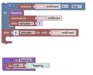

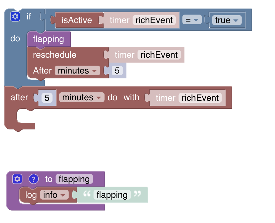

4th example:
this.tm.check(“richEvent”, “5m”, null, true, flapping);
Create a timer for five minutes. Do nothing if the timer expires. If called again when the timer already exists, call flapping. Reschedule the timer for five minutes.
  • Reschedule the timer for five minutes: What should happen there? If I get your code right it does reschedule the rule that doesn’t do anything
  logger.info('flapping')
  flapping();
  this.timers['richEvent'].reschedule(zonedDateTime.now().plusMinutes(5))

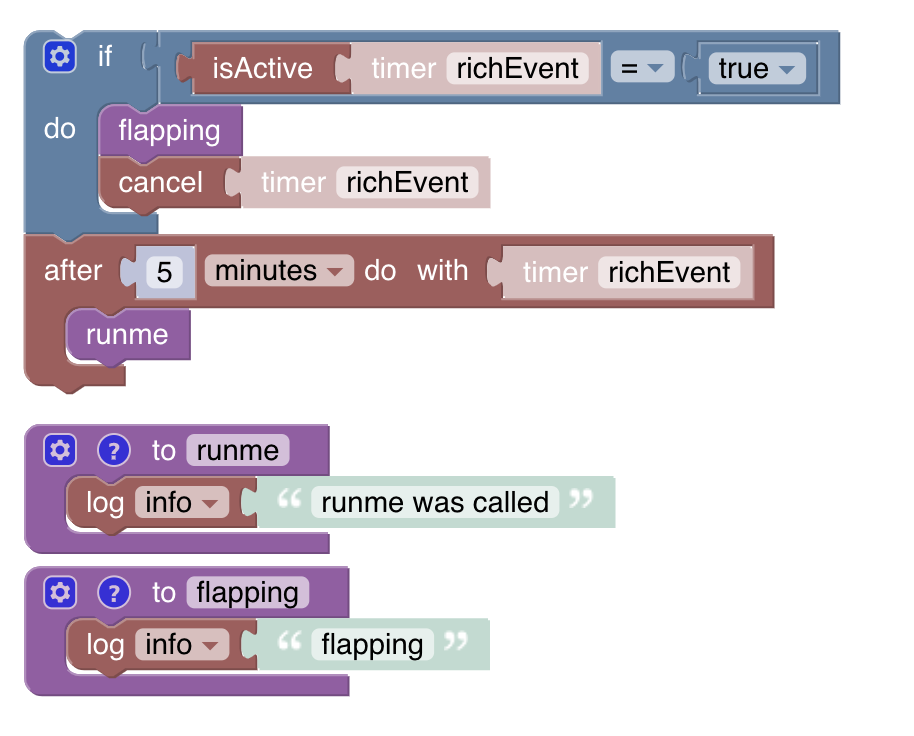

5th example:
this.tm.check(event.itemName, “5m”, runme, false, flapping);
Create a timer for five minutes. Call runme if the timer expires. If called again when the timer already exists, call flapping. The timer will be cancelled and runme will not be called.
function runme() {
  logger.info('runme was called')
  flapping();
	  runme();

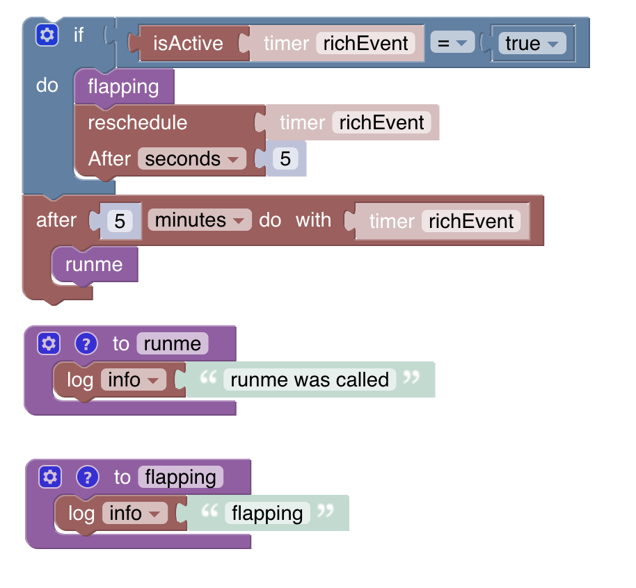

6th example:
this.tm.check(event.itemName, “5m”, runme, true, flapping);
Create a timer for five minutes. Call runme if the timer expires. If called again when the timer already exists, call flapping. Reschedule the timer for five minutes.
function runme() {
  flapping();
  this.timers['richEvent'].reschedule(zonedDateTime.now().plusSeconds(5))
	  runme();

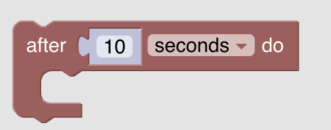

Dear all,
i dont want to interrupt your discussion however, I do have a question.

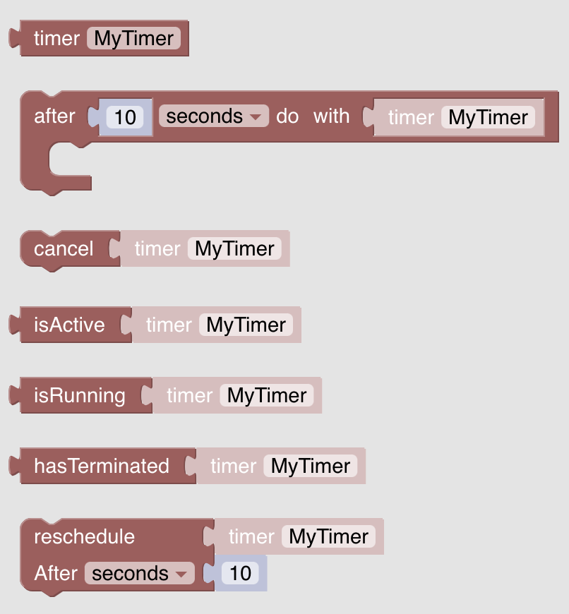

I really like the idea behind blockly but i am really missing the timer or delay functions.
Is there a way to use your custom blocks already.
If yes, can you give me a hint how to implement / install them to my openhab 3.1 version?
Thank you a lot for your work!!
They are work in progress and not available yet. Everything you see above is currently in the making and under review. All screenshots you see above have been done by me and are part of the Pull Request which is under review.
So stay tuned - I hope we can make them available soon but reviewing the code is a lot of work for the people doing it (which is important to have a good design and good implementation quality).
Hope that clarifies it.

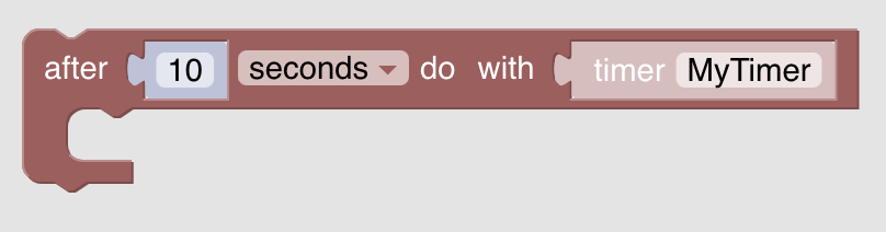

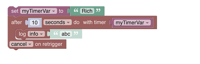

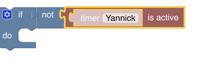

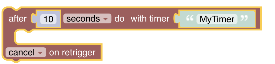

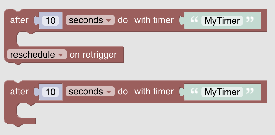

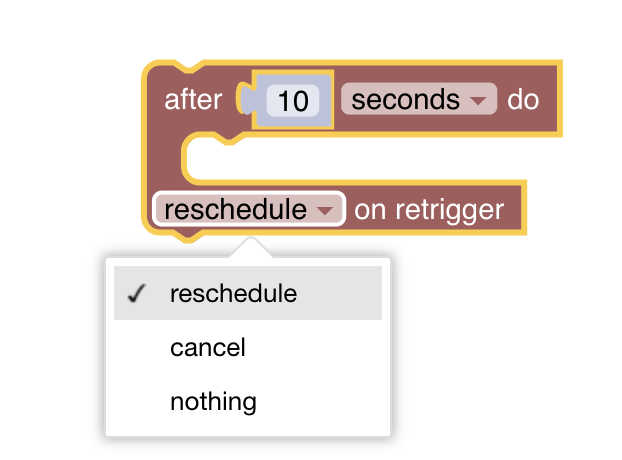

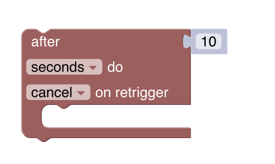

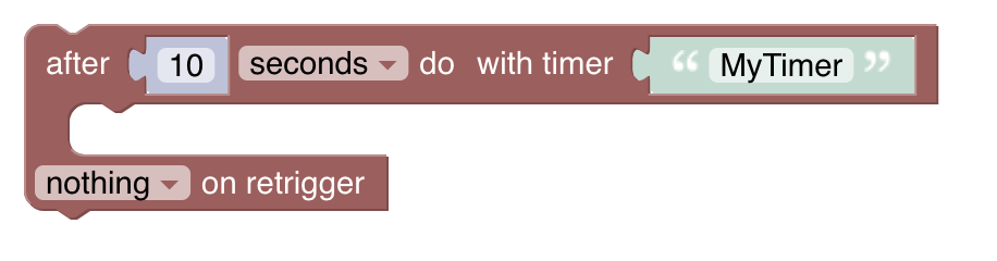

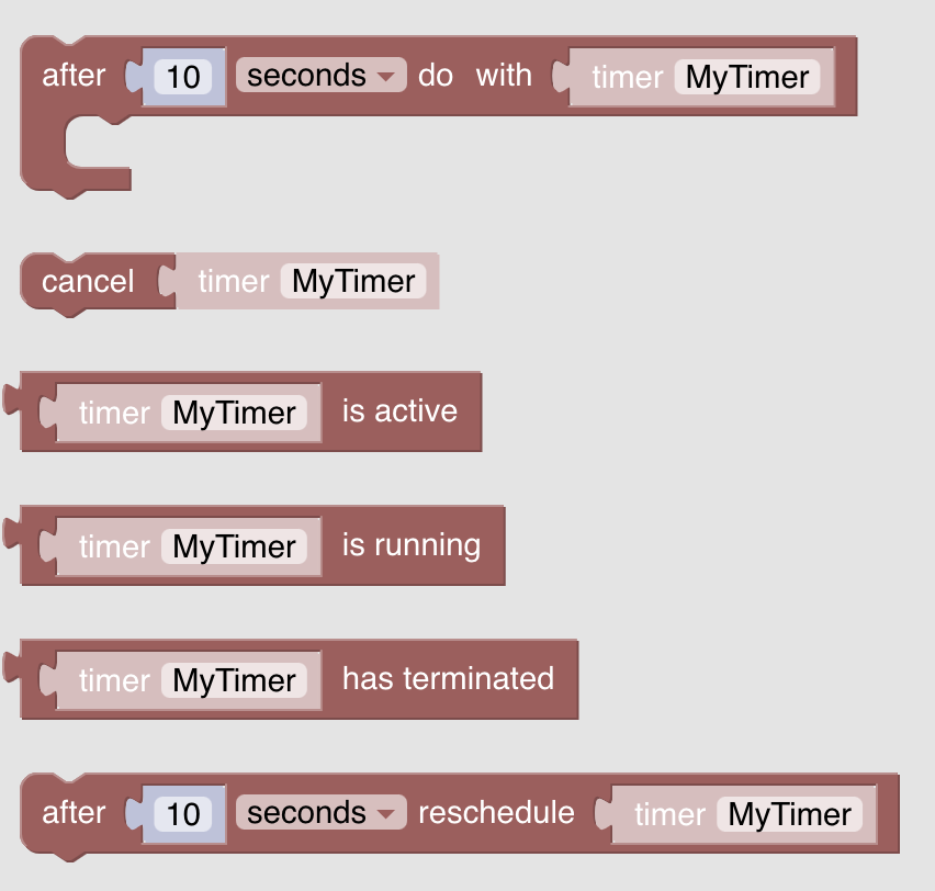

I’m not using timers in my rules (actually prefer to avoid them and use e.g. the expire profile instead) so I really have no strong opinion on these regarding implementation. It looks fine though!
On the design though, I’d put the “cancel on retrigger” part below the statements.

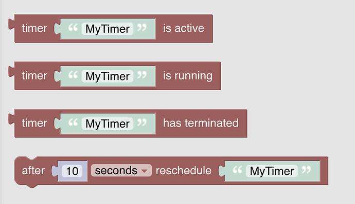

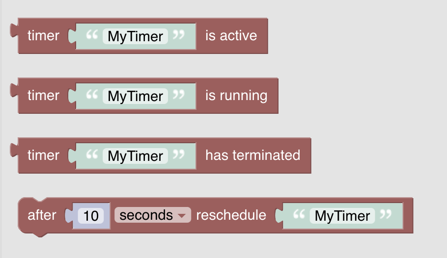

If the timer names are now just string identifiers, I’m wondering why we would need a separate “timer MyTimer” for those - just use regular text blocks and let the users manage the timer names themselves.
Same for the other blocks that should avoid technical names, and for instance
  • “isActive {shadow “timer MyTimer” block}” => “timer {shadow regular string block MyTimer} is active”
  • “hasTerminated {shadow “timer MyTimer” block}” => “timer {shadow regular string block MyTimer} has terminated”
  • etc.
If you’re hardcoding all simple timers with the "simpleTimer" name then you can’t have several of them at the same time - maybe even among multiple rules.

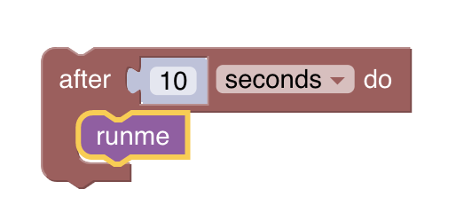

That make some sense. I wish there were a way to figure out what the most common use case is for timers. I could also see cancelling being used just as often as rescheduling. But rescheduling more closely follows the behavior for Expire so maybe it makes sense to be consistent. On-the-other-hand, if that reschedule behavior for Expire doesn’t do what is needed, maybe it’d be nice to have a simple block one that cancels.
Is it feasible to have two simple timer blocks, one that reschedules and another that cancels? Those combined will be by far the most commonly used I suspect.
Then the complex one can handle all the other use cases and the complex one can wait.
The code doesn’t match the blocks. Where is runme?
As examples though that looks good. I assume the code that sets up this.timers is there and didn’t make the copy and paste? I’m just looking for potential errors. The approach looks fine.
That’s going to be a problem for rules that trigger on a Member of a Group and sets a separate timer for each Item. We might need to do something a little hacky to get it working. I don’t think we can ignore that use case entirely.
The complex examples otherwise look good. Not too complex from the blocks perspective and the code looks OK too. The only comment I have is I generally prefer to use the items dict to get the state of Items rather than pulling the Item from the IR. It makes the code a little more concise and it works better in a couple of cases. So
would become
if(items['cancelRickTimer'] == 'OFF') {
It’s a minor thing that probably doesn’t matter in the long run.
Looks good. Straight forward and simple.
There is a bug here. Nothing is setting the timer to null in all cases. For example, when the timer is cancelled it wont return to null and therefore a new one can never be rescheduled. Similarly, runme doesn’t set the timer to null either so once the timer expires once a new one will never be created again.
If there is a way we can handle that for the user it would be kind of cool. For example, keeping the same blocks as above but produce the following code.

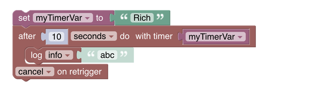

Of course. I just wanted to make sure we didn’t exclude any use case for a timer which always rescheduling would have done. The blocks above look easy enough to use and the code looks right.
Well, I’m not certain that we would necessarily need to implement my Timer Manager in Blockly, though that would be kind of cool. In text based rules it does save a ton of work, at least for me.
We have the problem with creating a unique name for the Timer to figure out though. Once we have that we would need the five arguments:
  • key: unique name for the timer
  • when: what time in the future to run the timer, in the block that would probably be two arguments
  • function: what to run when the timer goes off
  • reschedule: flag for what to do if the timer exists
  • flapping: code to run if the timer exists
I can see leaving flapping out and having the users code that on their own like your examples above.
So if we leave the flapping out I don’t know that there are any additional arguments. We’d just need to be able to manage timers by something more dynamic than a hard coded name (i.e. the name is based on a variable). And maybe the best way to handle that is with a separate block. Then it’d be more generic and we can store almost anything on an Item by Item basis, not just Timers.

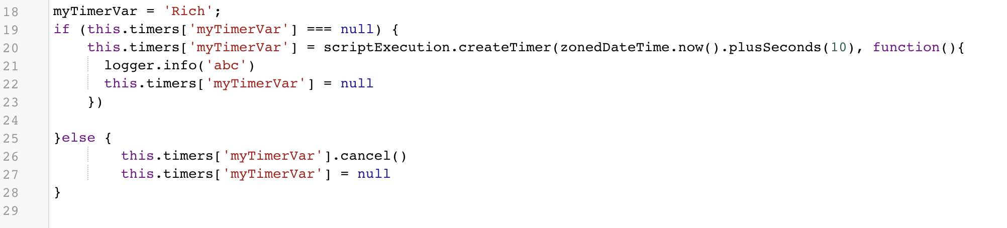

Can a text block be populated with a variable? That’s a pretty big need for writing rules where one needs to manage one timer per Item that triggers the rule, which is a really common use case.
I’m about 95% certain that isn’t a problem. Individual scripts (Script Actions/Script Conditions) appear to be completely isolated from each other. Reuse of variable names, isn’t a problem like it was when using global variables in .rules files.

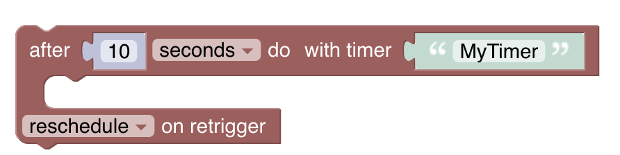

Yes, probably, let me see what I can do quickly here
It was just forgotten. It is actually in the code.
Yes, it is all there. I just didn’t want the boiler plate the comment.

This one is clear to me. When I cancel I don’t want to do anything with the timer anymore.
this.timers[‘richEvent’].cancel();
this.timers[‘richEvent’] = null;
I’m confused with setting the timer to null whenever I create it: Why would I set the timer to null if I may reschedule it later ? See Use case Number (4) below. If I would set the timer to null here it would break the code (null pointer) on the reschedule.

       //but still reset timer to null ->  would break the reschedule.
Yes, I agree, I was just too quick and lazy when I did the image :wink:
Technically true, let me think about it. Usually typed things are nicer but I agree that this is currently not checked yet.
Regarding this here
in changing it to “timer rich” - “is active”:
  • Would you expect to completely omit the logical comparison against true / false? I am even not sure if this works on the if clause. I need to check that because the if, I think, requires a logical comparison block.
  • How would I then ask if the timer is not active? “timer rich” - “is not active”? This would result into two blocks for each state (“is active” and “is not active”) which is something I wouldn’t like but I may misunderstand you.

Yes and yes it will work. Anytime you see foo == true or false, just using foo will suffice. So both in the block and in the code I wouldn’t expect to see the explicit comparison to true or false.
Hmmm, good point. Can you not put a not block in front of the isActive block? If not then we’d need to decide whether to compare it directly to true or false or add an is not active block. Adding a new block reads better like prose but might lead to a proliferation of new blocks.
If the block output is a Boolean type, then it can be inserted in a if block directly.
To test if a timer is not active, there’s a “not” block in Logic that can be inserted.
Finally I think that this is a good idea. So it turns to be like that:
and
Each of the is/has-block have been typed to be a Boolean to link safely.
Regarding the inner timer block
I would like to keep it as it makes the fact that this is a timer more clear.
Btw, I tried to make this to really become a typed block like so
this.setOutput(true, ‘Timer’)
and use that in “setCheck” but I couldn’t get it to work unfortunately.
Regarding the simple timer
I was think to add a timer name as well but then the block would loolk exactly like “normal timer”
and couldn’t be distinguished. The alternative would be to add the retrigger option like so
What do you think?
I disagree, I think extracting the “timer” label and making clear the timer identifier is a string makes sense.
For instance if you were to compute timer identifiers with Text blocks like this:
If you didn’t have the “timer” prefix in the outer block itself, how would you know what actually is active?
Like so?
I edited my comment while you were answering. See also my comment on the simple timer above with the retrigger. Feedback is appreciated there as well.
These are looking quite good now :+1:
Looks good. Very usable I think. Users will be very happy to get access to timers like this! :smiley:
Thanks Rich, I haven’t worked on the null-topic above due to the comprehensive answer I need comprehend first.
Meanwhile, can you please check if this is the expected code (with null-setting) for the “simple”-timer?
var scriptExecution = Java.type("org.openhab.core.model.script.actions.ScriptExecution")
var zonedDateTime = Java.type("java.time.ZonedDateTime")
if (this.timers === undefined) {
	 this.timers =[]
if(this.timers['MyTimer'] === undefined){
	 this.timers['MyTimer'] = null
if (this.timers['MyTimer'] === null) {
	this.timers['MyTimer'] = scriptExecution.createTimer(zonedDateTime.now().plusSeconds(10), function(){
}else {
		this.timers['MyTimer'].reschedule(zonedDateTime.now().plusSeconds(10))
// left out initialization part
}else {
		this.timers['MyTimer'].cancel()
and
}else {
The last line of the function passed to createTimer needs to be
Though in this case I think it will work just fin without it because even after the timer expires it will be rescheduled. However, there still might be an issue with the variables inside that function becoming stale over time. I think it is safer to recreate the timer after it’s expired rather than rescheduling a timer that has terminated who knows how long ago.
In addition, the line right after calling cancel() needs to be
also because the function passed to the timer never had a chance to run and set it to null itself. Without that, a new timer will never be created because `this.timers[‘MyTimer’] will never be null.
For the last one, again the last line of the function passed to the timer needs to set the timer variable to null. Then remove the else entirely as it’s not needed (unless it’s easier to keep it there as a noop.
Sorry I missed this, yes you can of course.
like so
	  logger.info('abc')
}else {
	this.timers['MyTimer'] = scriptExecution.reschedule(zonedDateTime.now().plusSeconds(10))
Not sure what I should do in this case? do a timer.create in the else branch? The the else branch would become equal to the if branch which wouldn’t make sense
like so?
	  logger.info('abc')
}else {
If that’s okay, I need to do thorough and comprehensive testing tomorrow to make sure all this works as expected (only did the coding so far for the changes)
Unfortunately it doesn’t behave as expected
