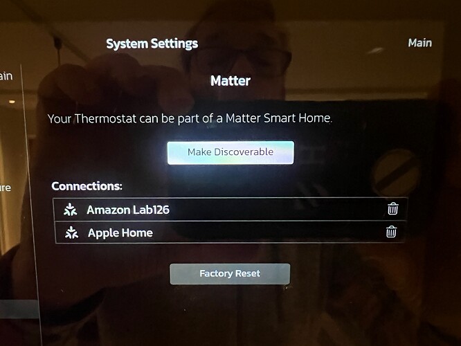

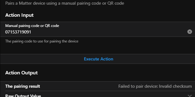

Created a Controller and tried pairing the Device but getting a failed checksum error

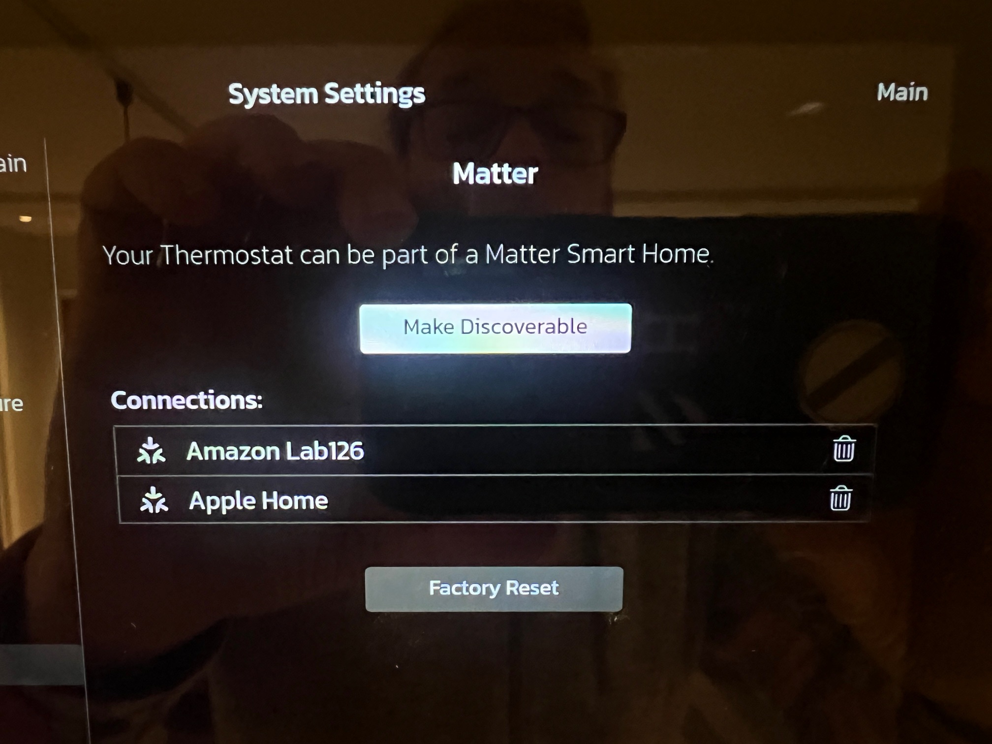

Here is how the pairing code is represented on the device, I tried with and without hyphens
I was able to add this device to Alexa (Echo Show 8) and Apple Homekit.
The thermostat vendor just recently add Matter support with a software update. The thermostat is connected by WiFi to my home network.

It looks like you inverted two of the first four digits when entering the code in OH. :upside_down_face:
You put “0715”, the code picture says “0175”.
And a pairing code can be used only to pair with one controller, you can’t use the same pairing code to pair the device with many controllers.
In the Apple or Amazon app there is an option on the device to generate a new pairing code which is valid for ~15 min, that should be used in openHAB (just as openHAB can generate a code to add to another system). Hyphens are optional, and won’t make a difference (just for making it easier to read).
Entered the pairing code correctly and the thermostat paired as expected!
