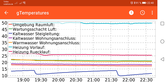

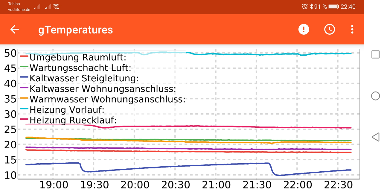

Update : After switching over to textual description of things and items, I got the channel binding established now. I still do not understand where exactly it messes up in my try with the GUI. Attached JFYI the 7 temperature sensor chart from the RPI operating now remotely acceses over cloud service. BR.
