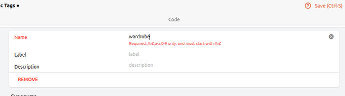

It works for me. But you must use a capital “W” for the name of the new tag.
Please show how you added this new semantic tag.
Yep, that was the issue. It would be nice if it is stated somewhere or (and) error message would be more informative. Thanks a lot!

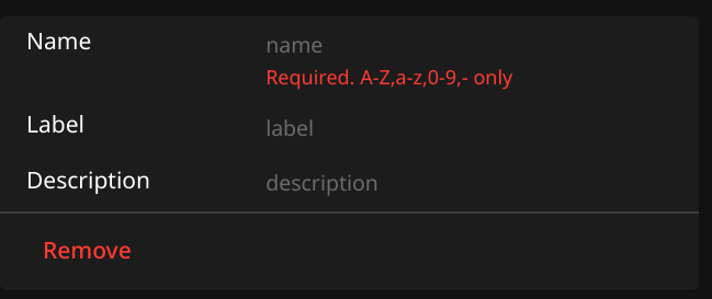

I got a pretty useful warning before I hit save.
That’s how I knew it needed to start with a capital letter.
Very strange… That’s what I got on 5.0.3. Probably it’s already fixed.
OH 5.1 has lots of small improvements like this.
