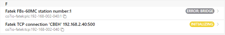

I’m stuck, the binding discover my CBEH and Fatek but bridge has status Initializing.

Hey, I have to check build status because this error happened with earlier versions. I know navigation over nexus listing is not obvious, but can you please check what was build date for your KAR file (it is part of filename after 4.0.0)?

Please use 4.0.0-20231106.121241-2, part after 4.0.0 is build date (2023.11.06 12:12:41), thus it is more recent than version you picked first (I know nexus navigation is counter intuitive).

Thanks Łukasz, I assumed the date was in American format:). Yes i installed some addons from community marketplace yesterday. when I installed block libraries, errors appeared.
