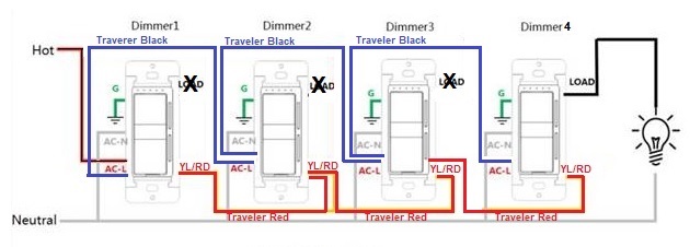

I installed four FEIT Dimmer switches on one circuit in my hallway. Currently my hallway lights turn on and off but only from the Dimmer Switches located in Boxes 3 and 4. The tiny green LED lights and little white circle turn on and off on Dimmers in Boxes 1 and 2 (independently of the other switches) but do not control the lights.
Any ideas on what I’m doing wrong?
Here is how I have my set up.
Box 1 (was a 3-way)
Line in (Hot) → AC-L
Traveler (Black) → AC-L
Traveler (Red) → YL/RD
Neutral → AC-N
Empty → Load
Box 2 (was a 4-way)
Both Black Travelers → AC-L
Both Red Travelers → YL/RD
Neutral → AC-N
Empty → Load
Box 3 (was a 4-way)
Neutral → AC-N
Empty → Load
Box 4 (was a 3-way)
Neutral → AC-N
Black wire to fixture → Load
