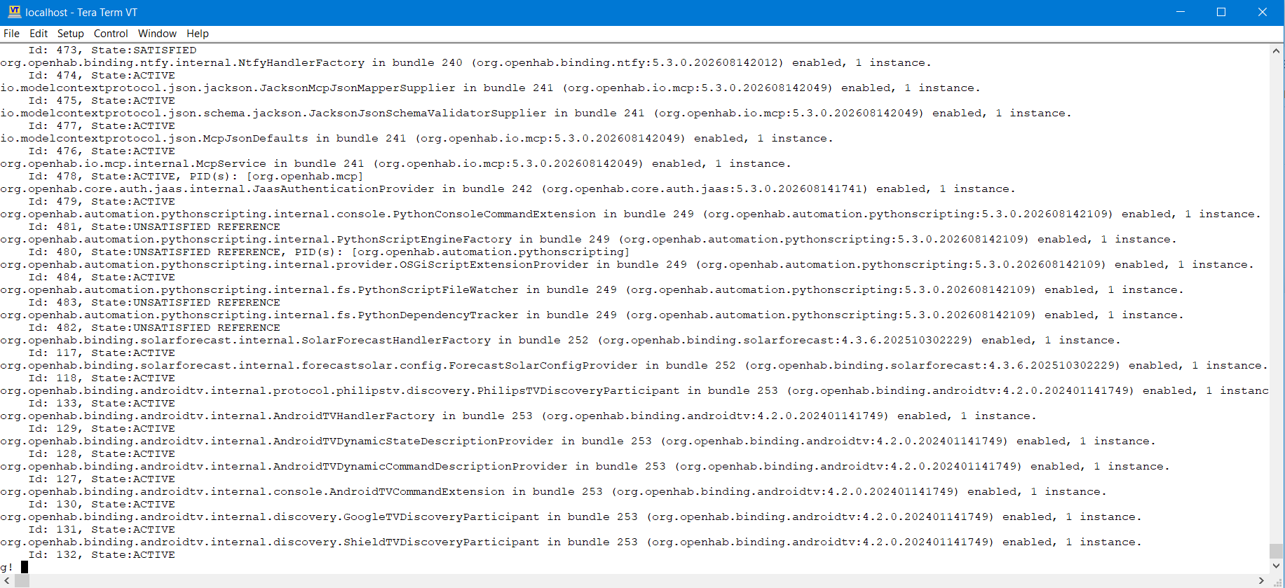

I found that there are a couple of widespread issues with most Telnet clients though. The Felix Gogo console arrogantly ignores what platform it runs on, so it uses LF only as newline. Surprisingly few Telnet clients for Windows can handle this, which results in any output basically being one long line, which makes it impossible to read. My beloved PuTTY can be configured to handle it, but it has another fatal flaw: no horizontal scrollbars.
While I assume that the newline problem is Windows only, the other problem is that the Telnet clients all want to wrap long lines. I assume that this applies to all platforms. The output when you list bundles can be quite long for example, and line wrapping will just make a complete mess of the output. I want it to behave like the Eclipse console does, with essentially unlimited line length and horizontal scrolling available should you need that. I’ve failed to find something that allows that and can handle newlines, but I’ve gotten pretty close with Tera Term. It’s Windows only though, but since I assume the newline problem isn’t an issue with other platforms, the available options might be better. Eclipse can actually open a Telnet client itself by opening a “Terminal” and selecting Telnet, but ironically, it can’t handle the newlines either.
