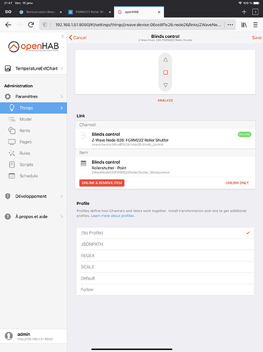

Thanks for the help. However I did not see any blue point on the right. I have the following page when accessing the channel:
Thierry
Thierry, I assume you have clicked on your item for the channel. That gives me the same view as in your screenshot.
Go back one level. You should see the list of channels for your device, like this:
Then click on the arrow on the right side of the blinds control channel to open the details and you should see the “Configure Channel” link.
Thanks again. If I clicked on the right arrow(>) (just close to the 100% in your image), then I go to the page I included in my previous post. Do not spend too much time on that. I will invert the wires and this will fix the problem.
