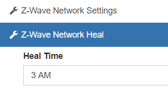

  1. Verify that you z-wave network heal time is not conflicting:

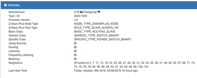

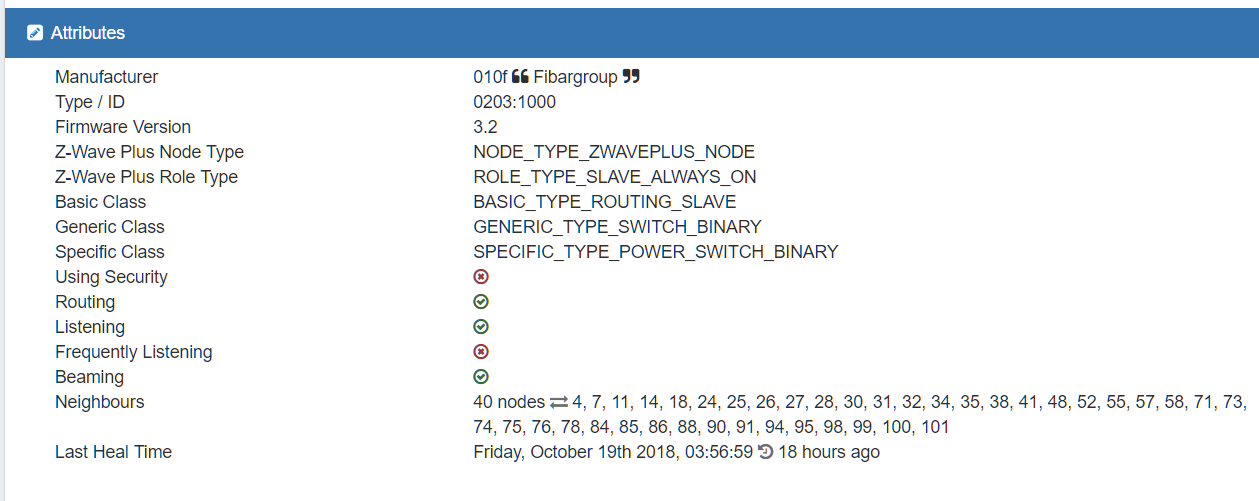

  2. Check that your node has some neighbours and that the last heal time is recent:
If your node is a leaf node, you might consider a repeater node to improve mesh coverage.
