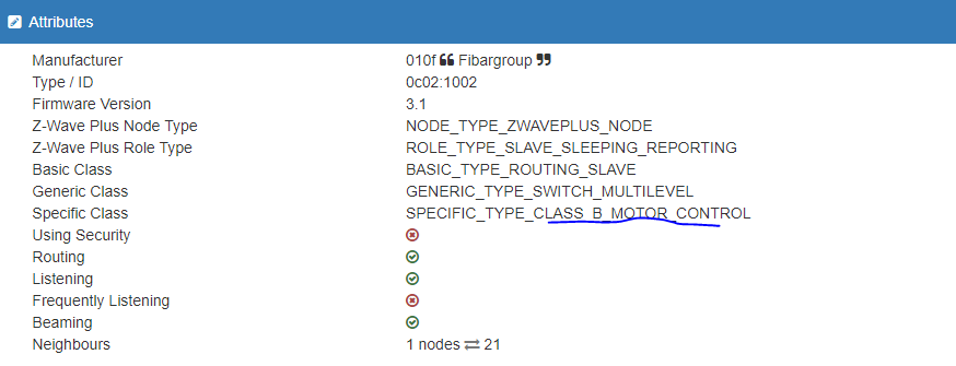

Thsat actually must be a buggy device cause if it is part of a network but wont sent anything. Mine did work now for almost 2 years and all of a sudden has that bug.
It still shows in a selftest to be part of the network. The controller has the node on it.
But a “range test” of the device shows it cannot communicate with the network (red). I have 50+ mains … so it should definately be reachable.
This information doesn’t come from the database. It might be a naming error in the binding or in the device itself. Either way, it won’t matter as this information is not used by the binding.
