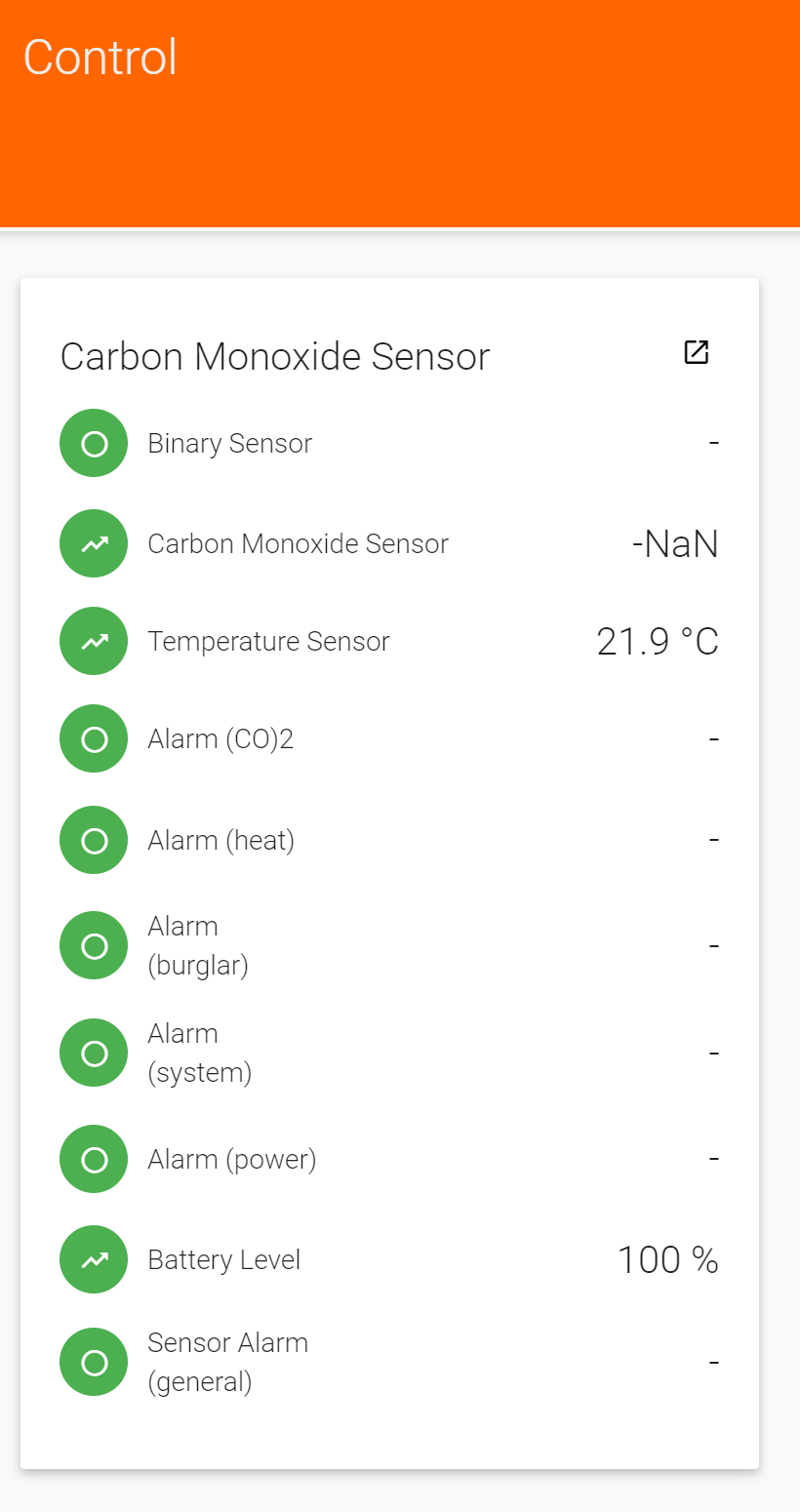

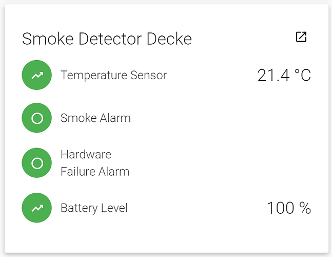

I have installed one Carbon Monoxide Sensor and one FGSD002 Smoke Detector from Fibaro.
Both are integrated successfully in openhab2 with Z-Wave USB Stick.
Both showing the temperature and battery level.
But all the alarms seems not working - see screenshots:
I’ve read that the status of the alarm should be “OK”.
Is there a configuration issue?
Thanks,
Stefan
Unless set with rules or manually triggered all Items default to a state of null since OH does not know its previous state without persistence.

Not necessarily. You can interpret NULL as meaning “no alarm” or “OK” in a user facing UI with a simple MAP.
But really, you need to establish if these sensors only report alarms, or should be reporting a positive “OK”.
I would advise against persisting the state of any alarm sensor. It kind of defeats the point, you might as well have a dummy Item fixed to “OK”.
