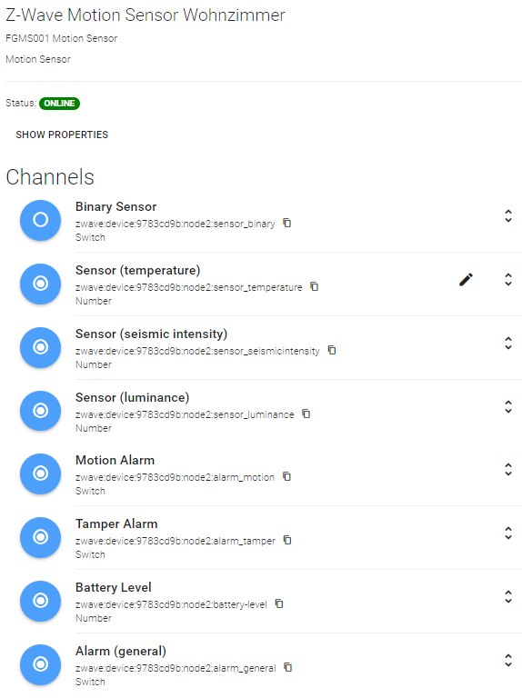

In PaperUI do you have all of the above listed and selected when you click on the thing?
Yes I do. All are listed there
With all channels selected?
I would suggest to use a newer version of the binding. 2.3 is now quite old and there have been a lot of changes.

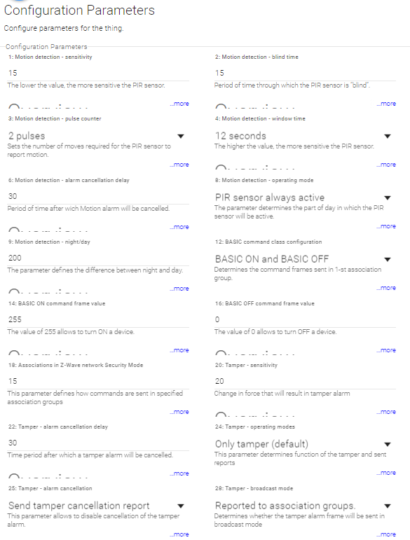

The Binary Sensor is not selected, but all the rest.

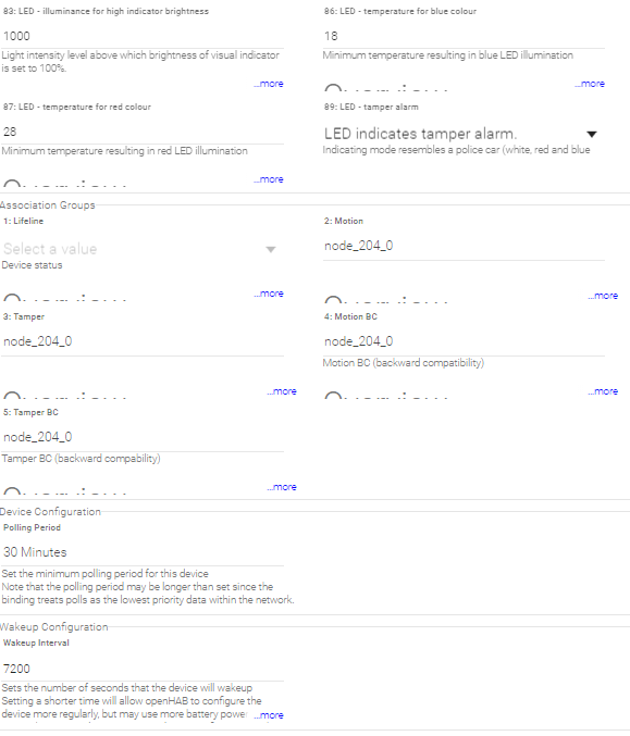

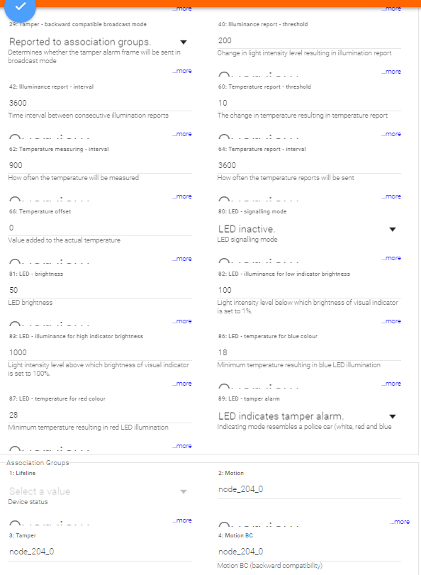

Yes it is, but all the settings are identical at both sensors.
  • Polling Period: 30 Minutes
  • Wakeup Interval 7200 Seconds
  • Illuminance report: 3600 Seconds
  • Temperature report: 3600 Seconds
