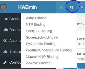

In HABmin, click on the search glass and select ZWave binding.
You’ll see a message flash in the upper right part of the UI that says you’re in include mode. From that point you have 30 seconds to triple press the button on the device.
Then by clicking on the little plug thingy, you should see it show up in the inbox, similar to this:
