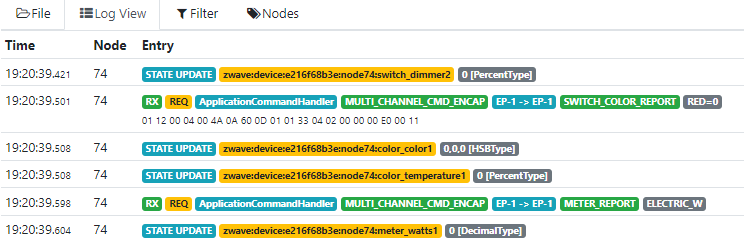

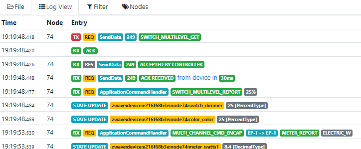

Probably need Zwave debug log while doing what doesn’t work right. Could either analyze at smartHouse log viewer or post and I’ll see if I can see anything when I get a chance. (I do not have the device, so I would only be guessing without a log
Hi Bob,
sorry for the late answer. In attachement there are the zwave logs from turning on remote via sitemap and turning the LED off via wall switch.
turn_led_off_wallswt.txt (8.3 KB)
turn_led_on_remote.txt (13.0 KB)
For me it looks like that with the wall switch only the coloer_temperature and the color itself is updated but not the dimmer channel I am using for the LED stripe control. Any ideas how to connect it? Maybe with a profile?
Regards,
Matthias
I think you are basically right (note the last number in the channel; blank=0, etc.). The wall switch is changing Dimmer on EP 2 and Color on Ep 1. OH items seem linked to EP 0. I’d assume the wall switch is actually how the thing is wired, so unlink your items from the channels you are using and link them to the same as the wall switch is using.
