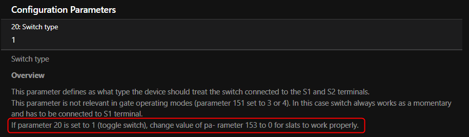

I have recently both another Fibaro RollerShuttter3 and connected to my OH3 system. For some reasons the controller makes additional move down after stopping the move up button. It is repeatable and independent on pressing switches on the wall switch or in OH3 channel.
Switch is bi-stable (ON and OFF)
- Switch Move Up button - ON - start moving up
- Switch Move Up button - OFF / or stop in OH3 (Stop)
- Blinds are stopping and moving down for 1 or two sec. Than stop
I have calibrated my Blinds several times. I have checked all parameters and compared them with another Fibaro RollerShutter 3.
Does some one experienced something similar? I have few Fibaro controller installed and none of them is behaving like that.
