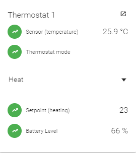

I am having trouble configuring my thermostat correctly - I dont know if Im doing it right. I have a Fibaro FGT-001 Thermostatic Valve with external temperature sensor. I have configured it in openHab UI so it shows me current temp and setpoint, with just linking thing channells with items. I have done nothing else. But when I set its setpoint it does not seem to take this into consideration and still keeps heating even if the current temperature is way past setpoint. Should I do/configure something else so it would work as expected?
2019-11-06 21:05:01.062 [ome.event.ItemCommandEvent] - Item 'Thermostat1_SetpointHeating' received command 22 ▒C
2019-11-06 21:05:01.106 [nt.ItemStatePredictedEvent] - Thermostat1_SetpointHeating predicted to become 22 ▒C
2019-11-06 21:05:01.132 [vent.ItemStateChangedEvent] - Thermostat1_SetpointHeating changed from 23 ▒C to 22 ▒C
2019-11-06 21:14:31.626 [vent.ItemStateChangedEvent] - Thermostat1_SensorTemperature changed from 25.8 ▒C to 25.9 ▒C
2019-11-06 21:24:30.450 [vent.ItemStateChangedEvent] - Thermostat1_SensorTemperature changed from 25.9 ▒C to 26 ▒C
If you need any other configs to diagnose, please tell me how to get it also - I am very new to this.

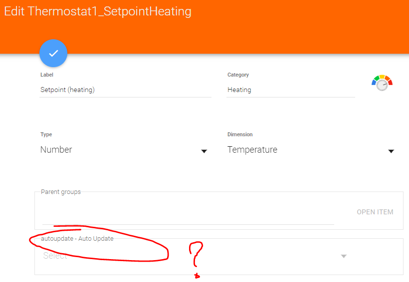

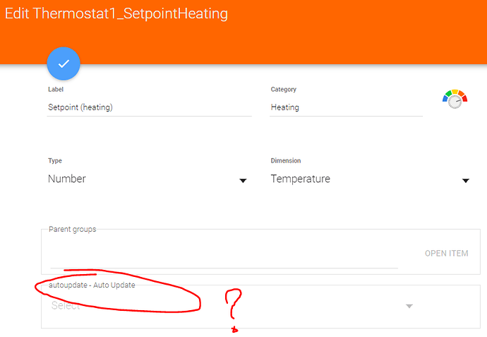

In the item “edit” section, there are only one field that’s similar to the “wake up interval” - “autoupdate” and I can set it to enforce. Is that something I should try?
Or did you mean by “check the wake up interval of the item” the actual FGT-001 device (thing)?

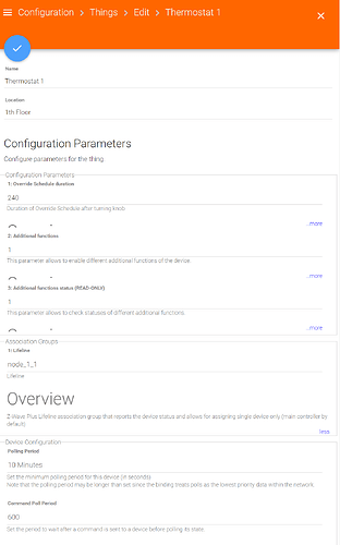

In the thing edit section there also aren’t anything about “wake up interval”. There’s a “Polling period” and it set to 10 minutes but that clearly isn’t affecting the setpoint because I messed for hours with it yesterday and the temp was climbing the whole time.

please try to set the lifeline to the z-wave controller. I have a Spirit valve which shows a comment, that a zwave plus node can only communicate with the controller.
