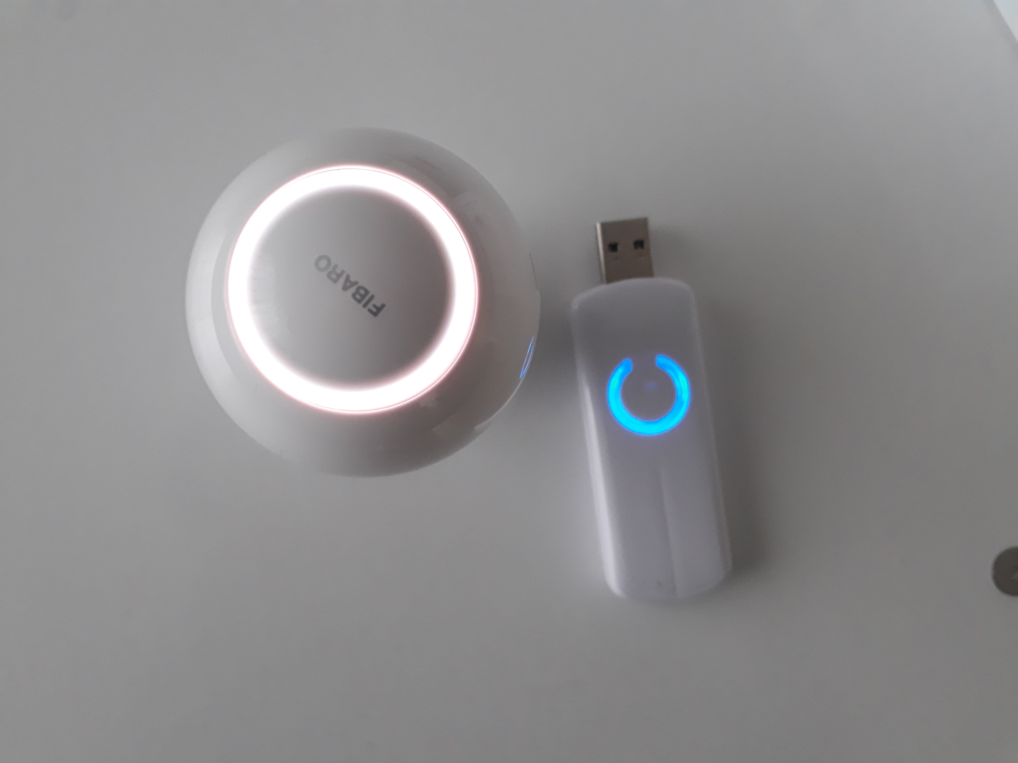

I am trying to connect Fibaro TRV with Aeotec Z-wave stick.
I press the action button of the stick one time to add the device (the led blinks blue) and then press the button of the thermostat tribe click (The led of thermostat blinks white), I wait for each other to connect but they don’t!

- Yes, I made the factory reset for both, but also not connected each other.

The issue would be the Z-Wave frequency in this case, I cannot mix and match Z-Wave frequency. This would indicate that Fibaro In Wall Dimmer are running on 908.42MHz which is the US frequency.
But the TRV is EU frequency running 868.42MHz which cannot connect to 908.42MHz.
