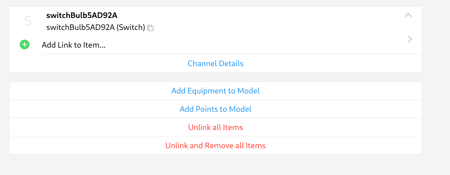

Observation in the UI
The item appears not correctly on the Things page
The UI doesn’t shows it as expected (see screenshot) when clicking the item
I toggle Light_GF_Bedroom_OnOffLight1, the log shows:
2026-01-10 23:46:28.308 [WARN ] [ui.internal.items.ItemUIRegistryImpl]
- Failed to retrieve item during widget rendering,
item does not exist:
Item ‘Light_GF_Bedroom_OnOffLight1’ could not be found in the item registry
So at this moment:
The item doesn’t exists in the UI
After restart / cache cleanup
