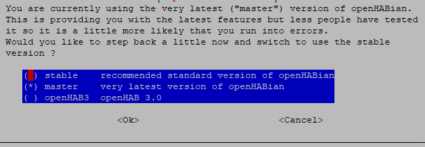

I have one other comment. It is not obvious (to me anyway) that the space bar is how to move the '", until I searched the forum for quite some time. I think allowing a '" to be entered to change the openhabian version might be more instinctive in the following. Just a thought.
edit: Thought of what is probably an easier option. Add sentence in the box above “Use cursor and space bar to change selection”
