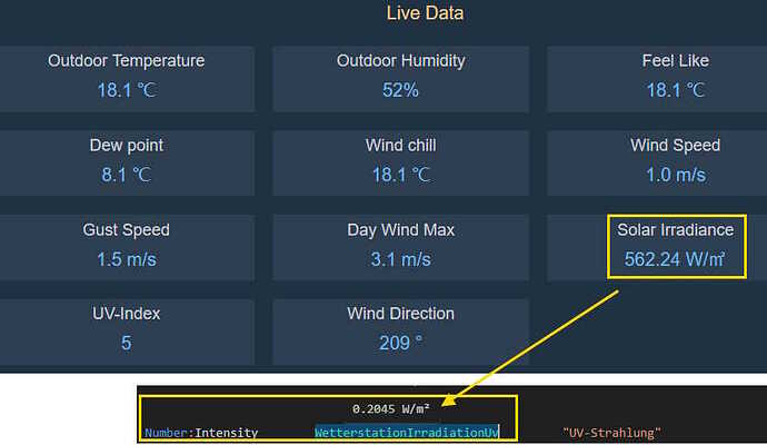

I bought a DP2000 7-in-1 Y-Edition and integrated it into OH4 using the binding. It worked straight away. All items were created automatically using VSC. Great binding!
I noticed that the value for solar radiation in OH and in the live data are very different. Do I need to do a conversion?
I have now solved my problem like this:
I convert the lx-value to W/m² using a rule.
I have not found any other way.

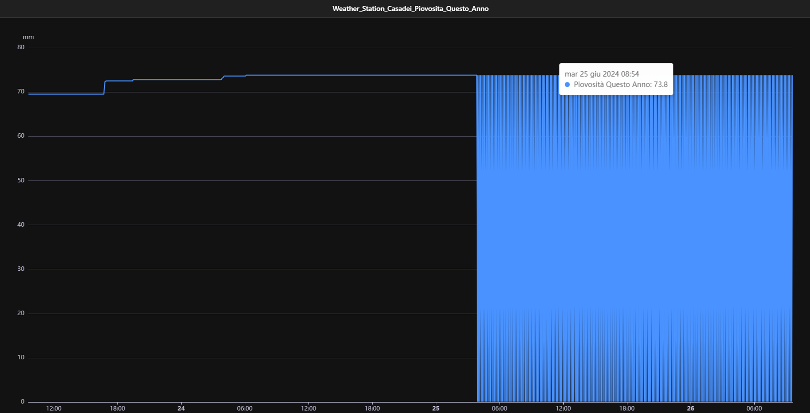

the annual rain ammount, became crazy last 2-3 days
rule "Strahlung"
    Item WetterstationIllumination changed
    Strahlung.postUpdate(WetterstationIllumination.state as Number / 126.7)
Strahlung is a Number-Item without Thing.
SOLVED removing the thing and creare a new weather things and link the old items to new thing channels

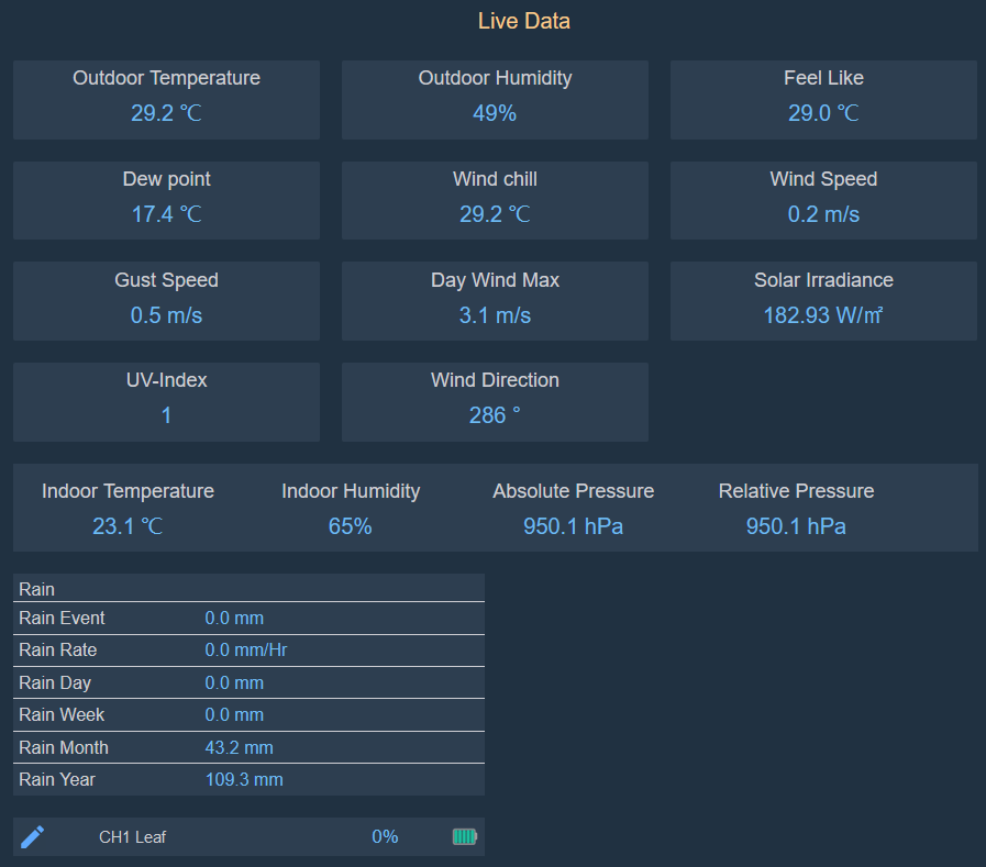

I added the WH35 - Leaf wetness sensor to my DP2000 7-in-1 Y-Edition. In OH I can only see the channels under the thing alternately. Always for about 20 seconds. Is this normal or did I make a mistake during installation?
Did you assign different channels to the sensors in the WS-View App? To further analyse the issue you need to provide some trace logs.
The sensor was immediately integrated into the web interface of the GW2000.
I then looked for the channel under the Thing in OH and there the display switched cyclically between the existing channels and the new channel. The setup worked and I also get values. It just alternates.
